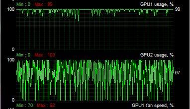

I face another very strange issue though. When i enable the 680 card, it throttles the performance. For example i have this scene which with 980 on i get 7 samples per sec. Enabling the 2nd card i drop to 5....
Now if i connect again the 2 screens on 980, i have the lag when full priority, but when i enable second gpu my samples go to around 9 (as expected).
Does this behavior sounds normal to u?
I really appreciate ur help on this
Continuing my last post: the card which has no screens attached on it doesnt go 100% as u see on msi afterburner... Thats why when i have the 680 with screens on i get throttle cause 980 cannot fully utilise its cuda.... What is this now?
Any devs around to confirm if this is normal behaviour? this wouldnt go unnoticed in multi gpu rigs and is major issue.
