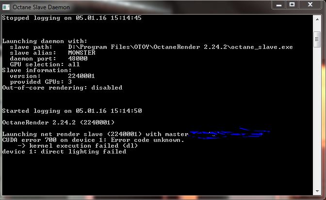

Hi Paul,
I got a cuda error 700 on slave
slave:
master:
Any idea?

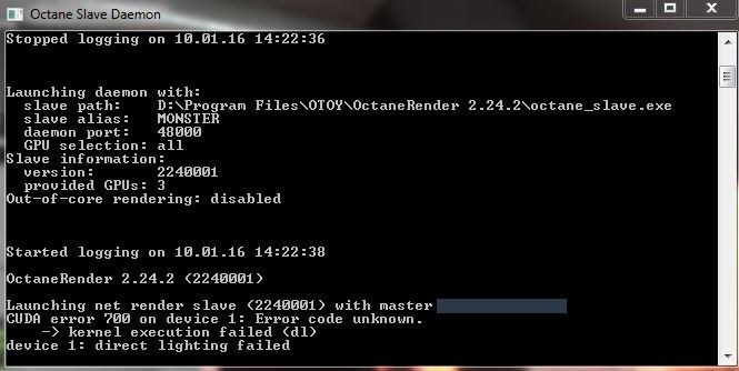

Same scene, another render target.
On one slave it has errors, on the other slave no problems.

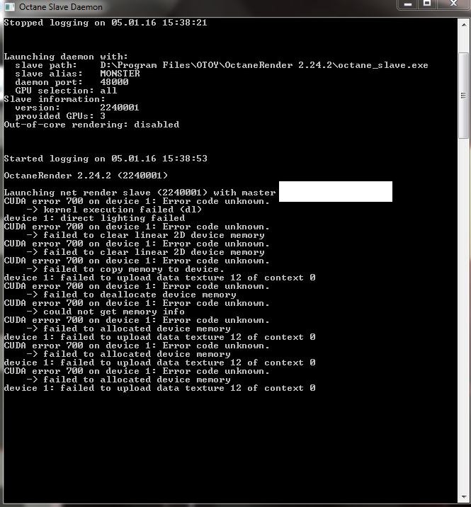

Hi Paul,
I also tried standalone 23.1 (instead of 24.2) and I get also the cuda 700 error on device 1 on slave when networkrendering.
Then I rendered on the machine with trouble on device one with the standalone to see if it only when using it as networkrendering.. and one gpu failes.
In log it says:
"CUda error on device 1: Errror code unknown
-> failed to unload module"
Might one GPU be broke, and shall I better post this issue in general forum?

Sounds like a hardware issue, but to be sure please send us the scene with which you can reproduce the issue and also the GPU model you are using.

I am afraid so. The error occurs with all scenes (I tried the benchmark scene), so sending a specific scene has no use.
The model is 780Ti. But only one of the three is having the error.
I will try to locate which one, and swap the slots they are in to see what happens.
Do you have any suggestion for me to test and figure out what kinf of issue this can be?
