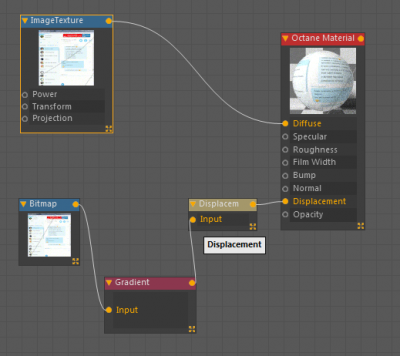

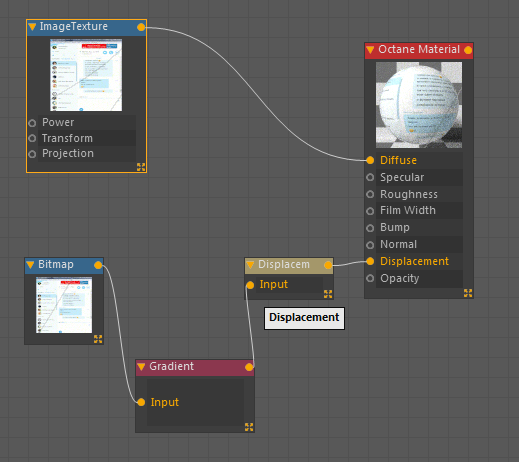

  • — displacement doesn`t work if image is not directly passed to node (for example via entermediate GRADIENT node)

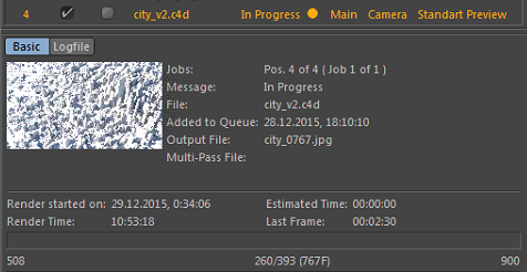

  • — doesn`t show estimate time in render queue

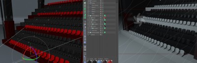

  • — sometimes doesn`t render shaders properly, but show correctly (when shader is assined to clonner not to clonned items directly (sorry for demo version screen)

1- Octane displacement doesn't supports any texture type else of image type.

3- I don't know any way to change "estimate times" here.
4-Probably you do somethings wrong or a fixed thing on newer versions. You may wish to share a scene to see what you do.
5-It's not a bug. Octane is gpu engine and cannot run any cpu shaders. Thanks to our shader to texture engine in plugin. We can convert some kind of shaders to images and use it. But you can't use any kind of shader like requires 3d space coordinates or relative to camera/objects. This will not work on baked textures.
