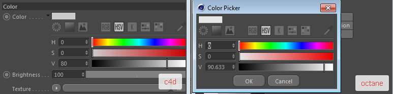

— wrong copying from cinema 4d color to octane color

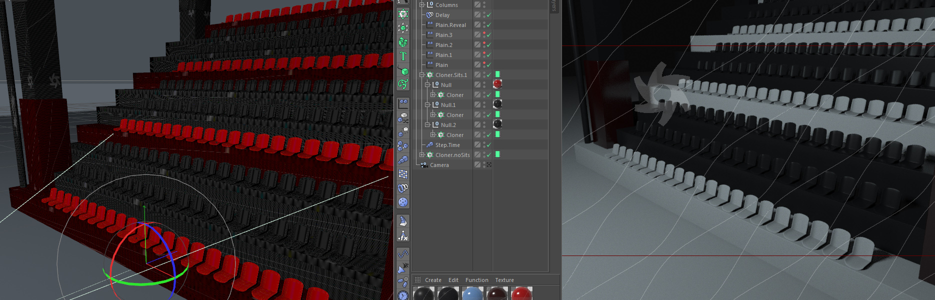

— sometimes doesn`t render shaders properly, but show correctly (when shader is assined to clonner not to clonned items directly (sorry for demo version screen)

2- I'm not sure the operation. But there shouldn't be any problems. At least for newer releases.

4-Probably you do somethings wrong or a fixed thing on newer versions. You may wish to share a scene to see what you do.
5-It's not a bug. Octane is gpu engine and cannot run any cpu shaders. Thanks to our shader to texture engine in plugin. We can convert some kind of shaders to images and use it. But you can't use any kind of shader like requires 3d space coordinates or relative to camera/objects. This will not work on baked textures.
