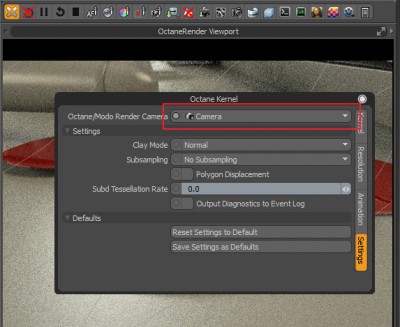

Is it possible to have Octane IPR automatically switch the camera depending on which camera is currently selected, rather than having to manually switch in the kernel settings?

That Kernel setting is actually the same property as the Render Camera in the Render item in the Shader Tree. So when you change the render camera, it should automatically update the camera used in the Octane Viewport.

Thanks Paul that's what I was after. Also looks like each camera has it's own Imager settings that's very cool.
