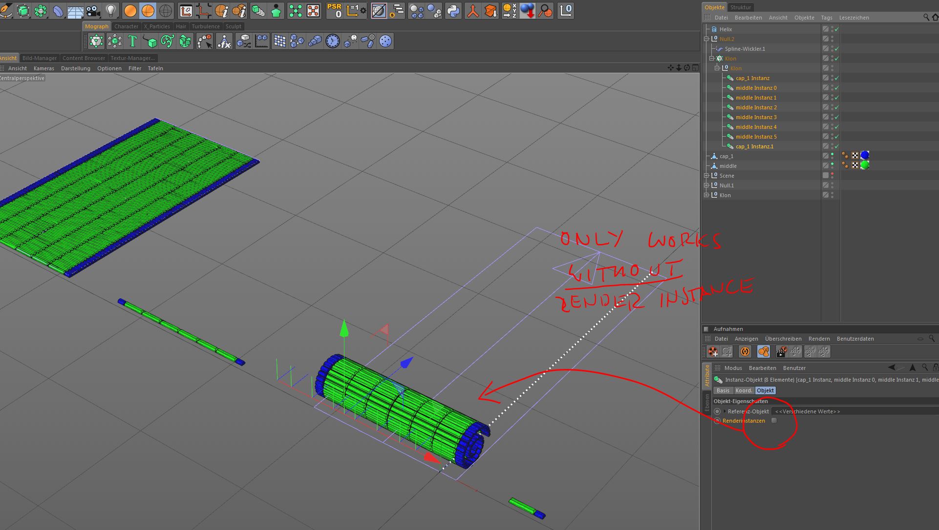

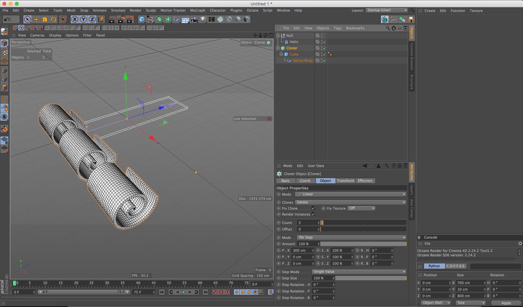

Since a few month I have the problem, that the cloner-setup gets
totally messed up, when checking render-instances.
I. have an object cloned linear to get a row/pattern and then that row is deformed
along a path via spline-wrap. Everything is fine until I check render-instances.
(but I need instances because of high polycount.)
I also get problems with render-instances in other situations.
Cannot remember having this kind of problems before.
Any idear?
thanks much!
MIke

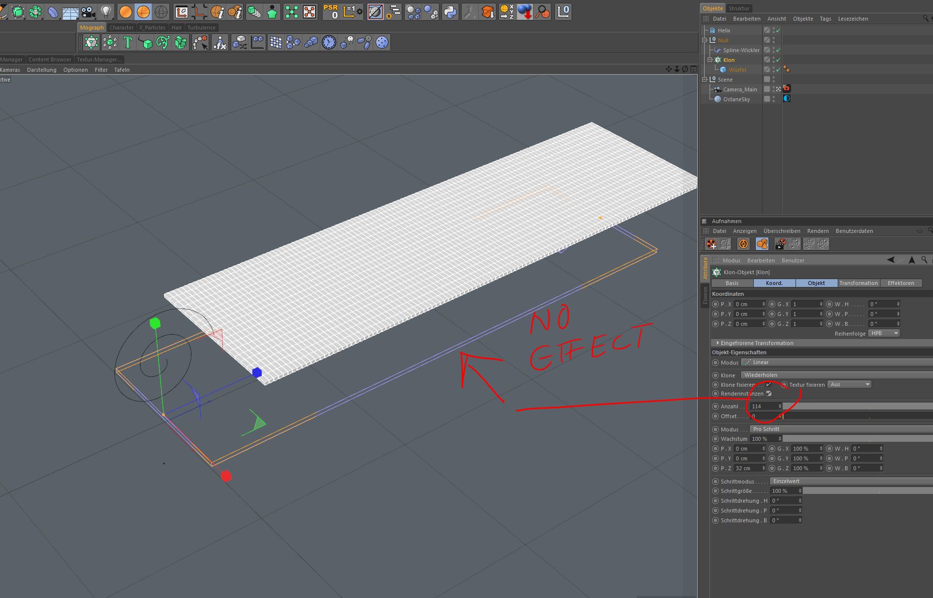

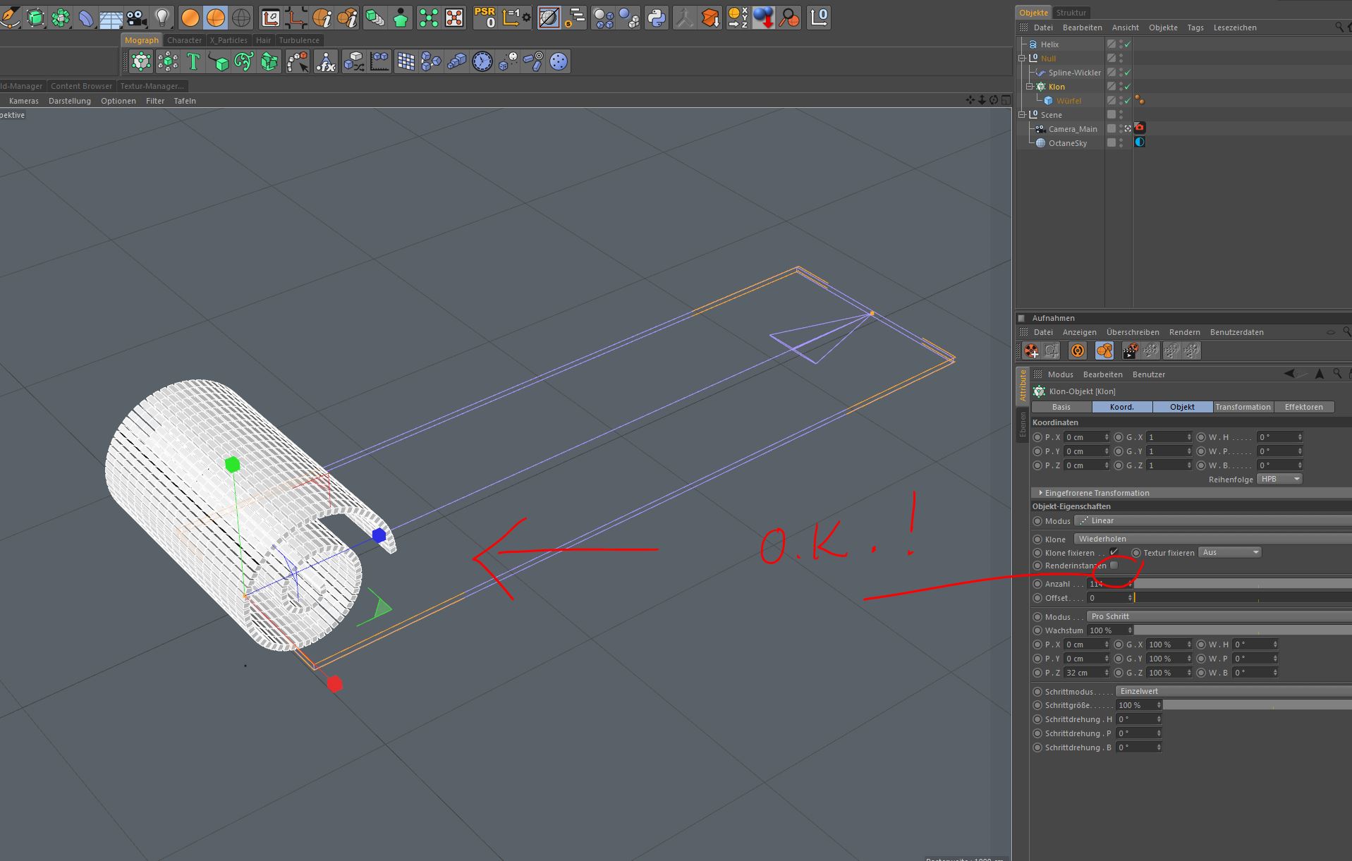

just to illustrate.
And I'm sure that this worked with instances
without problems some while ago.
Anyone else maybe having this issue?
thanks
Mike

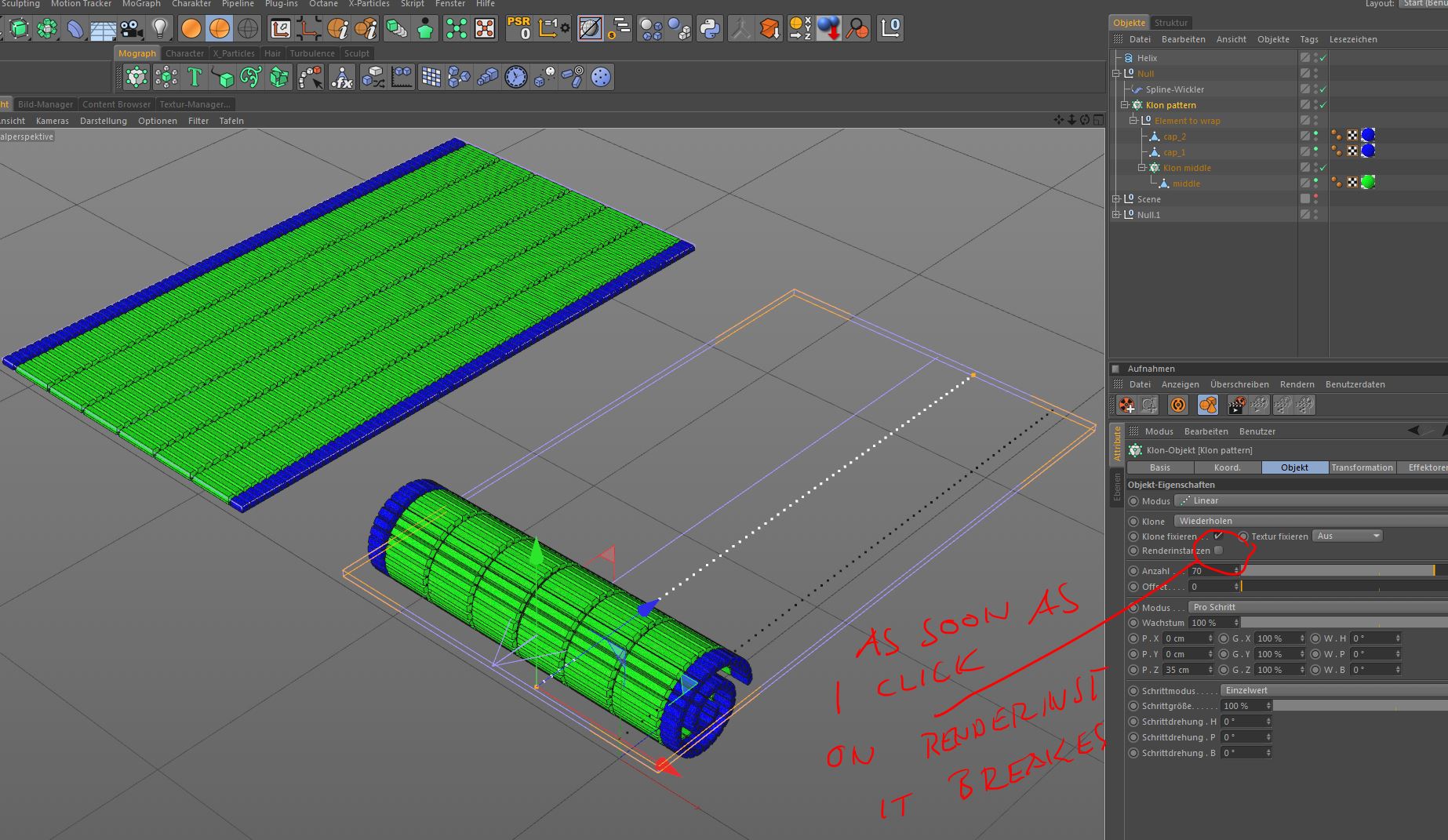

Hi beppe,
its more complicated but similar to this.
I need a very long stripe with high dense polys links/elements, which are
already also cloned (first cloner without "render instances" checkt)
As soon as I check render instances (for the stripe) it breaks.
But checking "render instances" should normally not change the mograph setup?
Or I'm wrong here?
Or is it a problem with R17 maybe?
I'll check with earlier version.
thanks
Mike

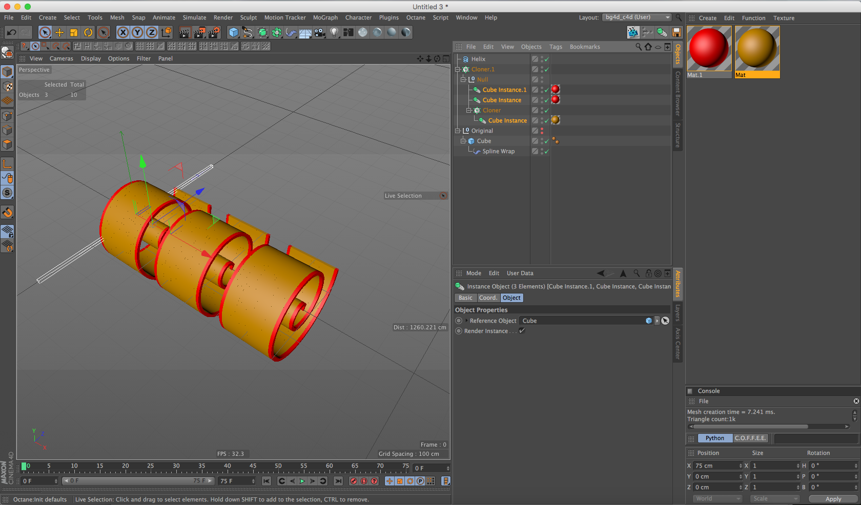

Posts: 10621
Ok, now I got it :)
here is a solution with instance object, the cloners does not have the render instance option active, only the instance objects have the option active:
ciao beppe

hmmm, totally confused now.
I will not understand, why my setup does not work.
Did it like this all the years.
When I try to place the spline-wrapper directly underneath the
original object, like in your example, it does not work.
Test_Rolle.zip
(150.41 KiB) Downloaded 119 times
regards
Mike

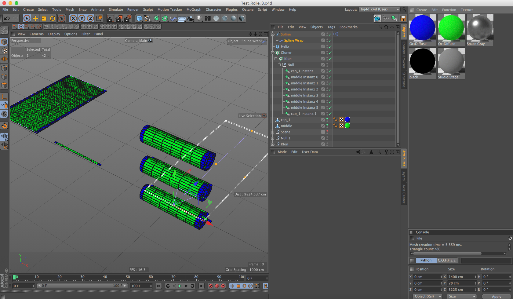

Posts: 10621
here is a different solution that deform the spline instead of the cloner:
Test_Rolle_3.c4d.zip
(171.34 KiB) Downloaded 117 times
I had to add an xpresso to avoid an unwanted rotation, but it should works if you fine tuning it for your needs, at least I hope so ;)
ciao beppe

Hi Beppe,
oh thanks!
Cool idear to clone the instances (with render instances turned on) along a spline
and then wrap that spline around the helix!
Of course this helpes a lot, because I now can use render instances.
