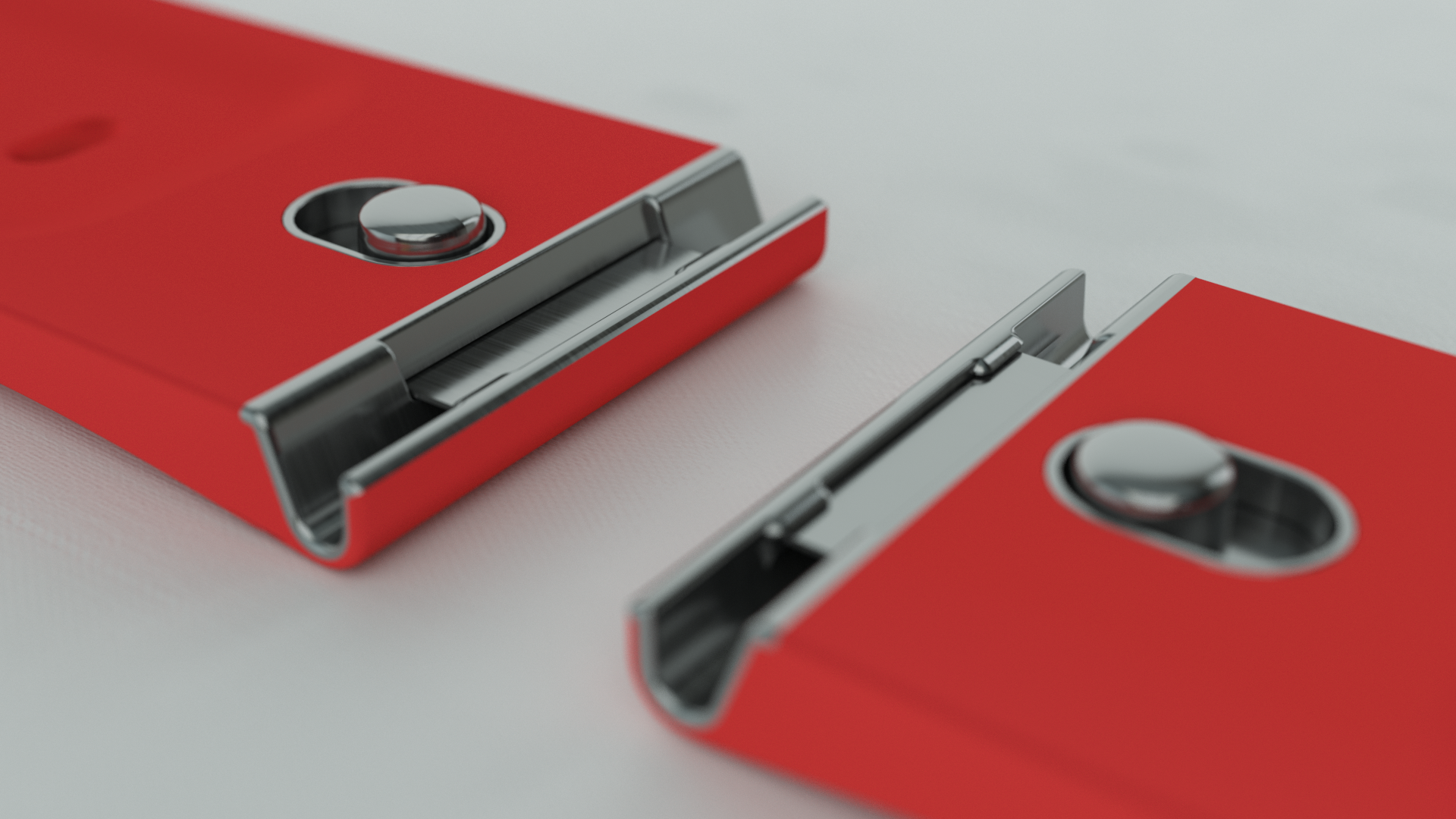

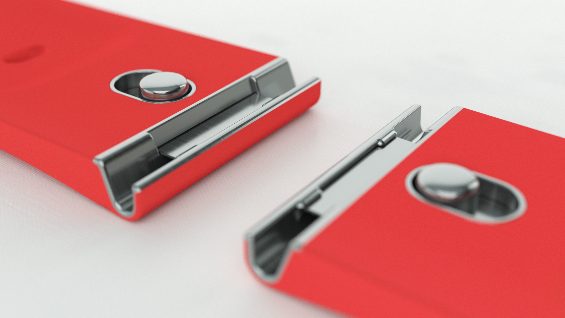

I've installed Thinkbox Deadline on my machine to manage my Octane renders. it seems to work but render looks a bit darker.
I'm submitting & rendering only on one machine. without any network related.
2 images attached. Darker image is the image that passing through Deadline.
Any ideas what can cause it? it doesn't seems like a gamma issue.
Thank you!
