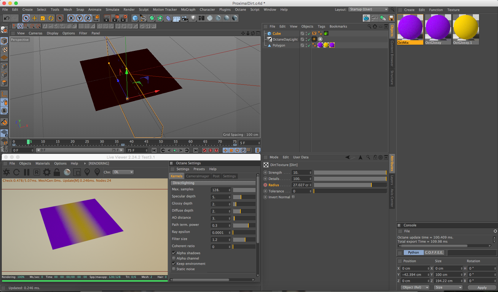

you could try to use a Dirt node to drive the effect, here is a simple example:
ProximalDirt.c4d.zip
(81.64 KiB) Downloaded 200 times
