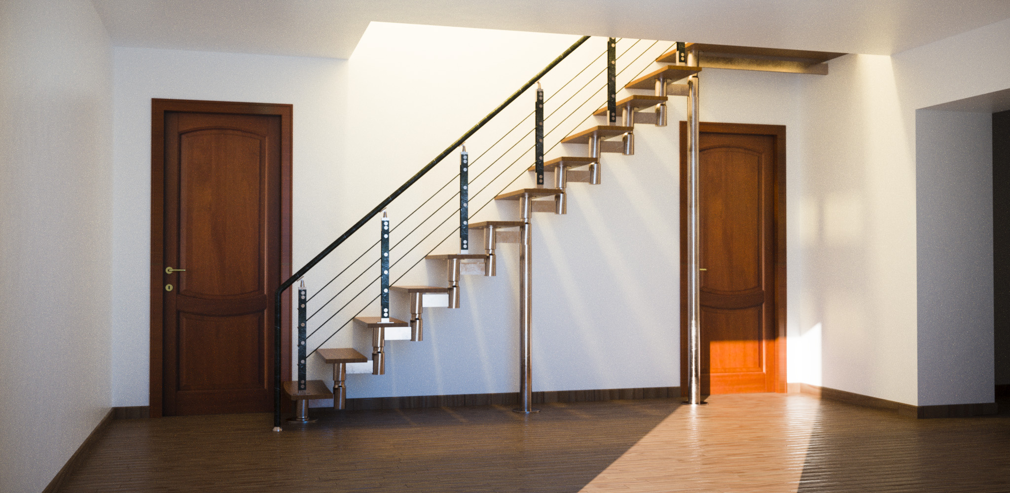

Still noise!
noldo
Posts: 94
Joined: Wed May 25, 2011 7:07 pm
Too much noise for this simple scene. 2 hours of rendering 780 gt Path Tracing & portal.
I think too glossy material.
smicha
Posts: 3151
Location: Warsaw, Poland
Set GI clamp to around 1.
RobSteady
Posts: 618
Joined: Thu Jun 07, 2012 7:33 am
And Caustic Blur to 1 as well.
Try to avoid reflection/roughness texture maps with pure white in it; I always mix them with a grey value.
Octane for 3ds Max v2.21.1 | i7-5930K | 32GB | 1 x GTX Titan Z + 2 x GTX 980 Ti
face_off
Posts: 15809
Location: Adelaide, Australia
The noise is in the dark areas - so reduce Kernel->Path Termination Power (from 0.3 to 0.1). Pls see the Octane Notes link in my signature for details.
Paul
noldo
Posts: 94
Thank's to all.
I try some experiment tomorrow.
