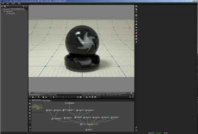

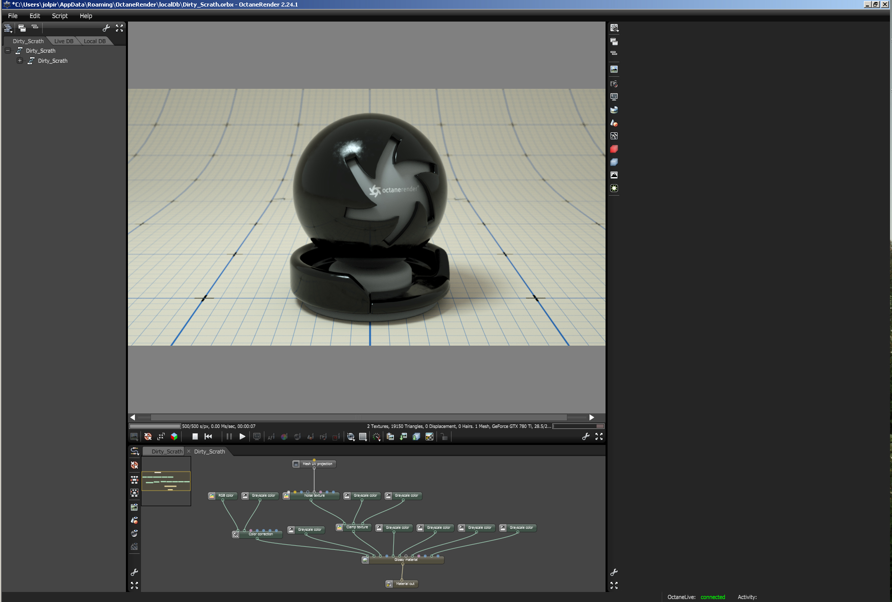

Still a problem to import the shaders is better but doesn't work for transforms and projections.
I think still not right with different combinations. add some print and orbx scene.

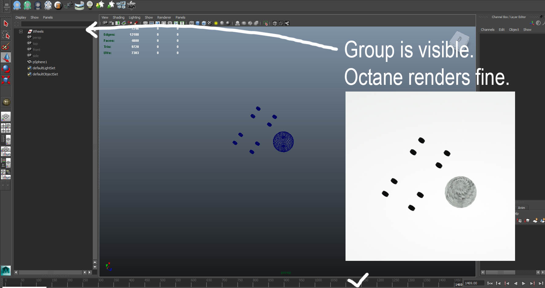

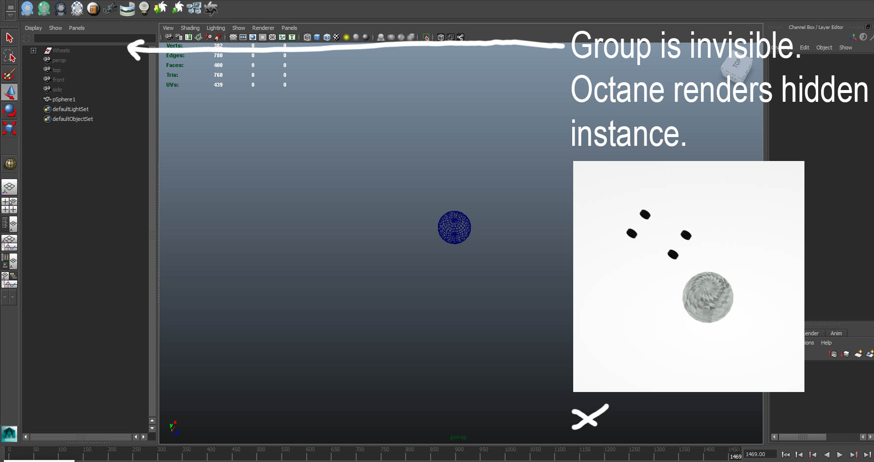

when I use the scatter attribute in Maya the visibility of the parent group is ignored.
Let's say I have a group with cubes that have a scatter attribute. When I turn off the visibility of the group this will not affect the instanced cubes. They will be still visible during render.

Refracty wrote:Hi JimStar,
Is there a way to change this?
( I was using Maya 2014 + Octane 2.24.1 for the test.)
This is was the case with the older versions also. What we did was scale to 0 the instances. and is working fine. Hope this help as quick solution would be good to have the features right. But working also well in this way.
I've just tried - works OK on my simple tests... Could you give me the scene where it is reproduceable?

Hi JimStar,
good to see you around.
I have extracted a small part of the scene which illustrates the problem.
Hope that helps.
