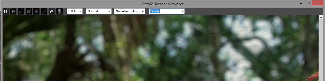

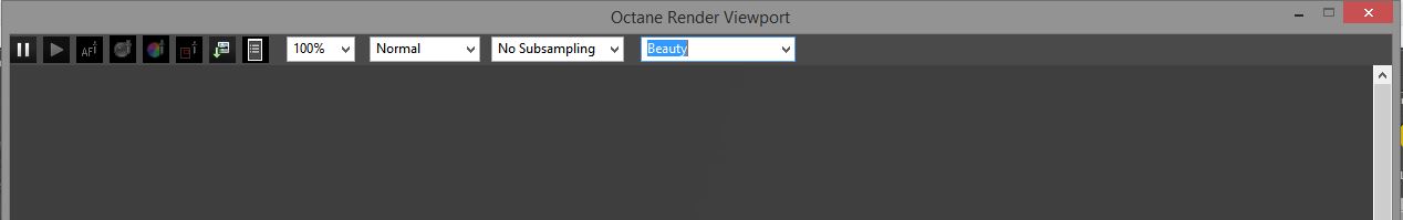

When I activate Render passes the first change of the viewport selection is ignored, which puts all following selections out of sync.
Example: I render an image in beauty pass display
initial display
initial display

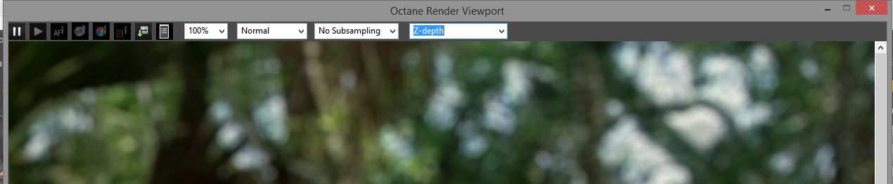

Then i switch to e.g. Z-Depth - the displayed image stays in "Beauty" mode
switched to z-depth pass
When switching back to Beauty the display changes to Z-Depth.

I'm on version 2.23.2.55, but this might be an issue in newer versions, too.
Win11/64Bit | GTX 4090 24GB | NVidia Driver 546.29 | Octane 4.05 | DAZ Studio 4.21
