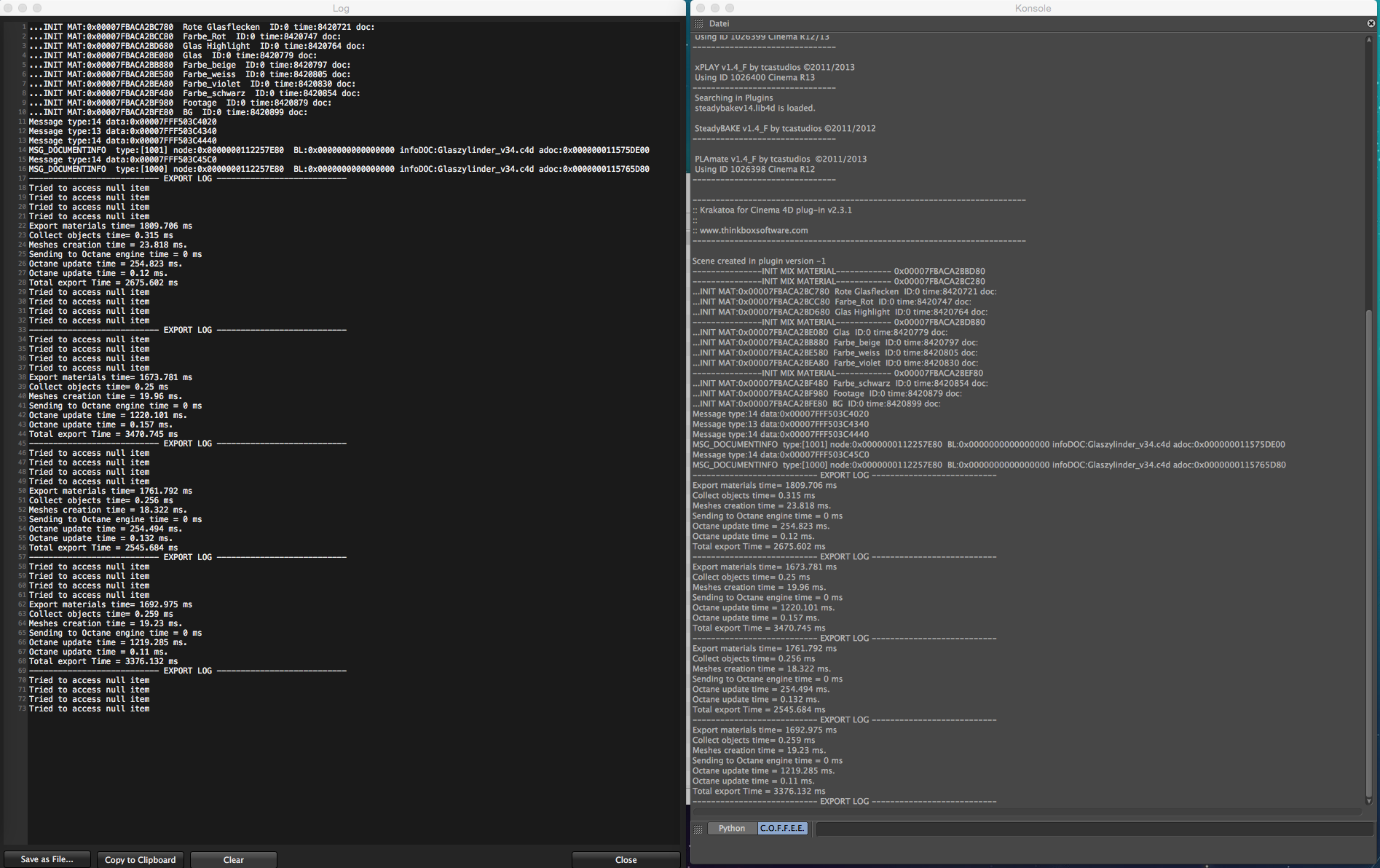

i attached the bugreport and a screenshot of the log and the console.

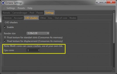

What do you read in picture?
skoeth
Posts: 67
Joined: Sat Sep 27, 2014 12:48 pm
it says "1" as well.
MacPro5,1 OS X 10.10.3 | GTX TITAN Black, GTX 970, 3x GTX 780Ti, GTX 780
Posts: 16068
Location: Türkiye
skoeth wrote:it says "1" as well.
What's yours?

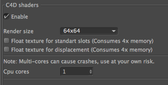

But i see the crashes are occuring in "RenderShader". It's about the baking C4D shaders. Please check again.
skoeth
Posts: 67
aoktar wrote:But i see the crashes are occuring in "RenderShader". It's about the baking C4D shaders. Please check again.
it is definitly set to "1". even when i try to change it it automatically switches back to "1".
one thing i just noticed it that its working fine when im rendering the scene in the picturemanager.
so is there any setting regarding the liveviewer that could cause the problem?
Bildschirmfoto 2015-10-06 um 15.38.51.png (19.9 KiB) Viewed 2688 times
