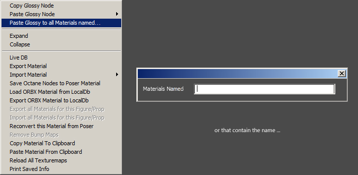

Andygraph3D
Posts: 268
Joined: Wed Mar 20, 2013 7:25 pm
It would be nice to something like ...
face_off
Posts: 15814
Location: Adelaide, Australia
You can already do this by selecting the material name you want to paste to and then selection the rightclick menu option "Paste Glossy to all Materials named [material name]".
Paul
