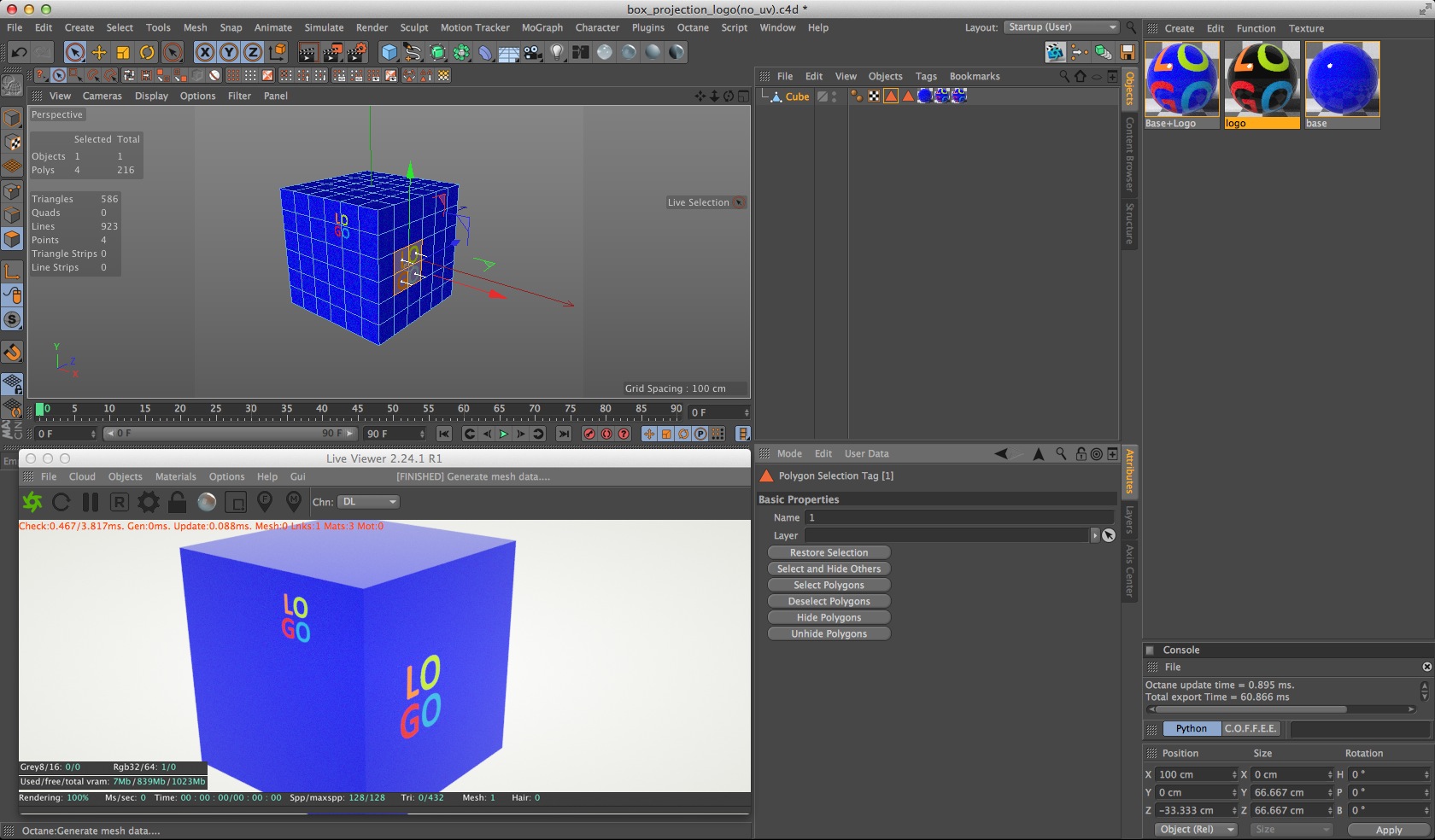

if you don't want to work with uvs in c4d, you can use the same technique proposed by abreukers but restricted to a polygon selection so you can more easily place the decals:
ciao beppe
box_projection_logo(no_uv).c4d.zip
(80.11 KiB) Downloaded 167 times

That is a good idea, but can sellection be too large? I tried that but i susspect my poly-count is too great. I dont know, any ideas are welcome. I cant figure it out.
Win 7 x64 # 12 Gb ram # 2 x GTX 480 # i7 950 (Corsair H50 cooling) # 1200w PS Corsair Gold
EVGA X58 # 2 x SATA6 SSD Raid 0 # 2 x SATA3 2Tb Raid 0 # Cooler Master ATC'S 840
Posts: 10621
hi,
a workaround should be to set the nurbs at a lower resolution before transforming into a mesh for semplify the polygon selections, an then add a nurbs object as a father for having again the correct subdivision :roll:
ciao beppe
