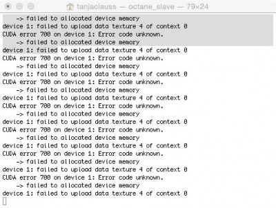

I am using a MacPro as a slave with two GTX780TI on board.
Although it seems that network rendering is working fine (green status line in PV) a cuda error appears in the terminal window when rendering .
Does anyone know what that means or how to get more info about the status of the slave machine in terms of: is it rendering properly / is it working on both cards / how much VRAM is used etc.

it seems that you have not enough VRAM in the slave
Which GPU has the master?
If the master has more VRAM you can activate the Out-Of-Core option during the demon install adding system RAM to match the master memory.

I am using the same cards in master as in slave: 780TI with 3 GB VRam.
I have already enabled out-of-score with 5 GB allocated RAM on slave, but not on master.

hi,
here you can find a post about enabling the verbose mode on the slave under osx:
viewtopic.php?f=14&t=50163
I wonder, if all the GPUs are the same on both master and slave, why you need the out-of-core option only on the slave?
Do you have the error even with a simple scene?
Have you tried with the standalone net rendering option?
Have you the same results like with the c4d plugin?
ciao beppe
