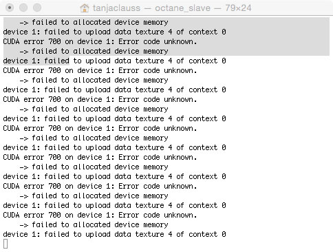

I am using a MacPro as a slave with two GTX780TI on board.
Although it seems that network rendering is working fine (green status line in PV) a cuda error appears in the terminal window when rendering .
Does anyone know what that means or how to get more info about the status of the slave machine in terms of: is it rendering properly / is it working on both cards / how much VRAM is used etc.

it seems that you have not enough VRAM in the slave :roll:
Which GPU has the master?
If the master has more VRAM you can activate the Out-Of-Core option during the demon install adding system RAM to match the master memory.

I am using the same cards in master as in slave: 780TI with 3 GB VRam.
I have already enabled out-of-score with 5 GB allocated RAM on slave, but not on master.

here you can find a post about enabling the verbose mode on the slave under osx:
viewtopic.php?f=14&t=50163
I wonder, if all the GPUs are the same on both master and slave, why you need the out-of-core option only on the slave?
Do you have the error even with a simple scene?
Have you tried with the standalone net rendering option?
Have you the same results like with the c4d plugin?
