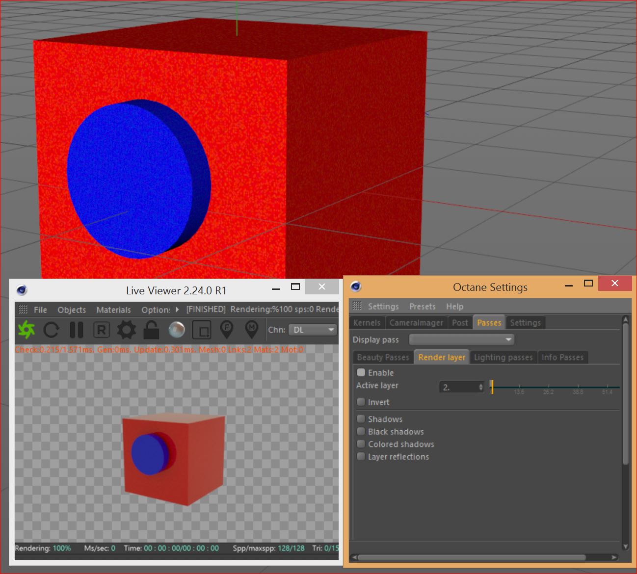

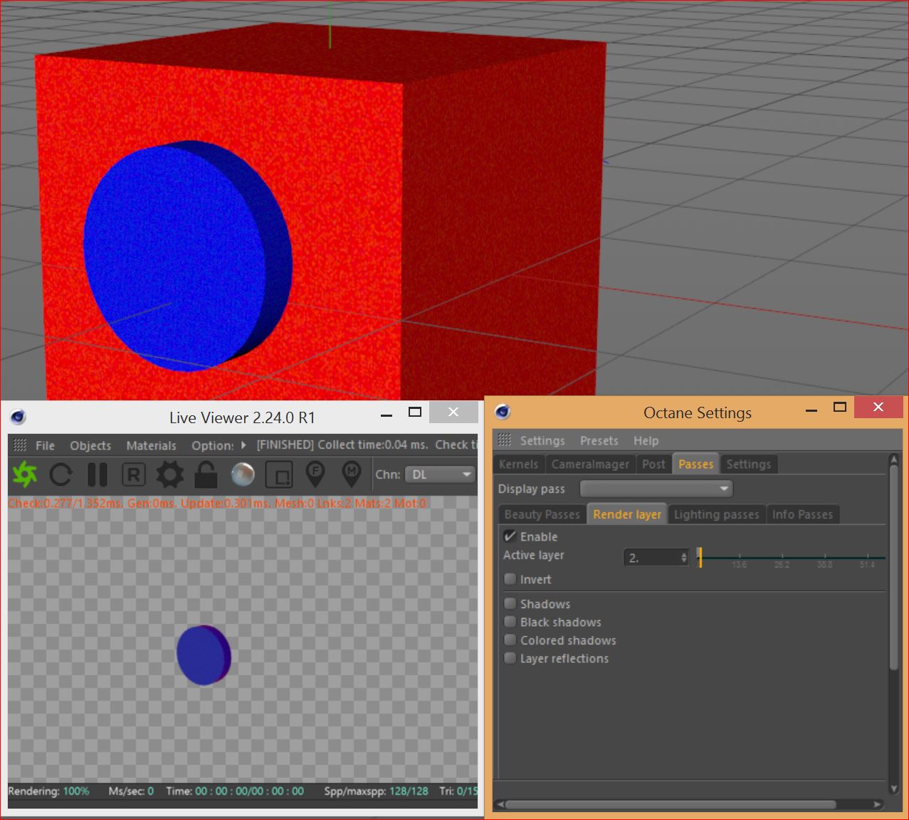

Hi Proxell
try this.
use a Octane object tag for the two objects, one for layer ID 1 and the other for Layer ID 2, then on Octane setting go to Passes > Layer and select Enable, you can obtain what you need in two ways, move the cursor Active Layer from 1 to 2 and see the result il LV. Or select simply Invert.
You must uncheck Keep Environment on Kernel settings and check Alpha shadows and channel.
Manu
