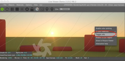

have you try by right clicking in the live viewer and choosing the "Toggle info" option?
By clicking in the window without a picker selected, the info bars are displayed or hidden ;)

weird, you should have something like this also with the demo :roll:
Is Octane correctly running?

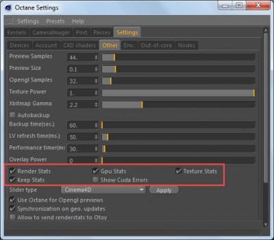

It also should be ON from settings as in picture.

Thanks guys, I did have those options checked... it appears they are that way by default.

Under "Help" select "Show GPU Info", as you'd expect. But GPUs don't show. Then right click the viewport and toggle info off. And then again right click the viewport and toggle info back on, now its there.
So, looks like viewport info settings are changed, but you just need to force that update.

Make LMB click on upper part of LV. It switches the modes.
