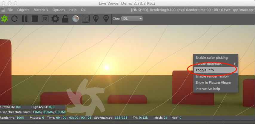

have you try by right clicking in the live viewer and choosing the "Toggle info" option?
By clicking in the window without a picker selected, the info bars are displayed or hidden

weird, you should have something like this also with the demo

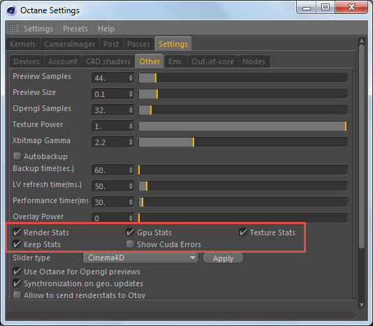

Thanks guys, I did have those options checked... it appears they are that way by default.
Anyway, after trying to bring up the panel a few times, I was finally able to make it appear.

I have the same problem. Nothing works. I've tried toggling info and show GPU info. I've checked setting > other and all check boxes are on.
