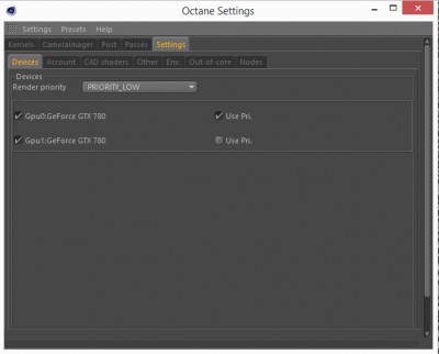

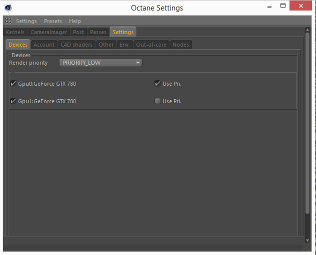

do you see any gpu names in devices section in settings? Can you render a simple box scene in Live Viewer.

Yes i can render a simple scene - even a complicated. But sometimes - this crush appeared. I am changing light emission - it happening... diffuse color - same stuff.
It usually crushes like 2-5 times a day - without any reason on light projects on heavy ones...
What i am trying to say - everything is working properly - but sometimes it crushes - like in a very random fashion

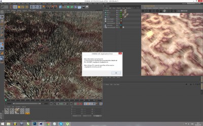

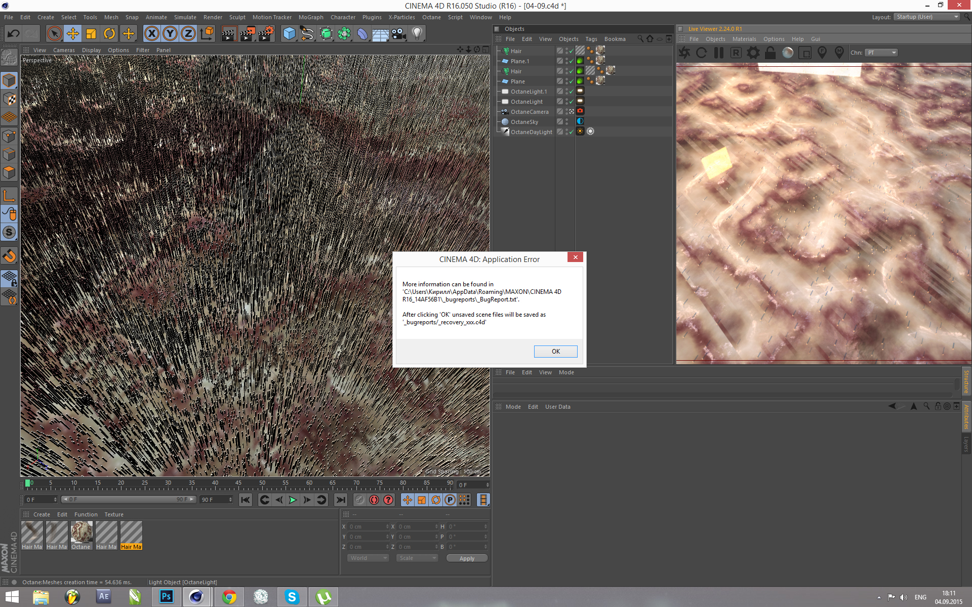

FOR EXAPLE!!!!
It's appears 1 min ago... i was rendered pics for several time - on last time - i just turned on the LV - and crush appeared)

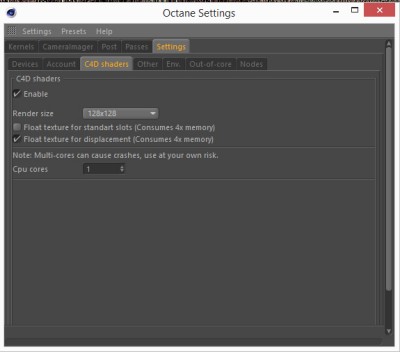

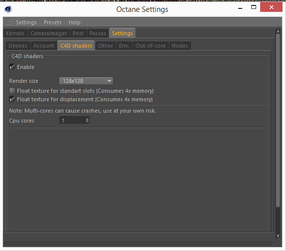

aoktar wrote:I see your the problem. You are using C4D's textures with multi-cores. But it's not stable for some textures. Set multicore=1 and say goodbye to crashes. Thought that i wrote a warning note to aside of this parameter.
You meant this tab like in a picture?
Yeah it was 4 - now i made it 1... i hope it will work =)
Thank you for helping - anyway =)
Posts: 16068
Location: Türkiye
Yes that's it. I see in bugreport the crash point.
