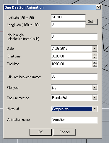

Does this happen for you when you render a sun study too? Or just with Bongo animations?
Paul
Paul
At the moment a sun study is calculated and there is no problem to write here. So it seems to be related to Bongo.
(Only I don't see a sun study effect at the animation, but I never did a sun study before, maybe I did something wrong. But I get frames rendered by Octane.)

I did a test and the Rhino renderer shows the sun study. Is there a trick needed for Octane? How to link the Octane sun to the Rhino sun? The Octane sun option shows a fix direction always.

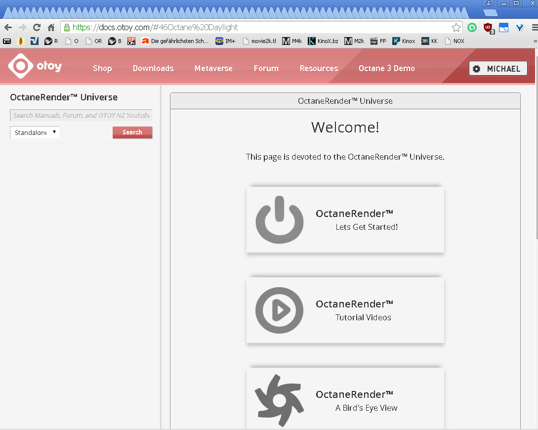

https://docs.otoy.com/#46Octane%20Daylight and https://docs.otoy.com/#46Rendering%20Animations should answer your question.

The sun works if I use the Octane viewport and edit the sun properties, but not if I start a sun study animation. At the animation is one sun state shown only.

PS: Your docu links doesn't open the pages, manually I can find them.

This is an example of how it works.The sun works if I use the Octane viewport and edit the sun properties, but not if I start a sun study animation. At the animation is one sun state shown only.
They work fine for me using Firefox.PS: Your docu links doesn't open the pages, manually I can find them.

Very strange, your file works, but not my setup. Attached my file.
At google chrome your links show the start page always.

The links are working fine on Chrome for me. I suspect you still have the sun turned on - you need to turn it off.Very strange, your file works, but not my setup. Attached my file.

Great, got it, turned the sun off for the sun study.
You could add a note at the Octane sun that sun and sun study are independent, f.ex like this "for sun study animation be sure to disabled the Rhino sun".
