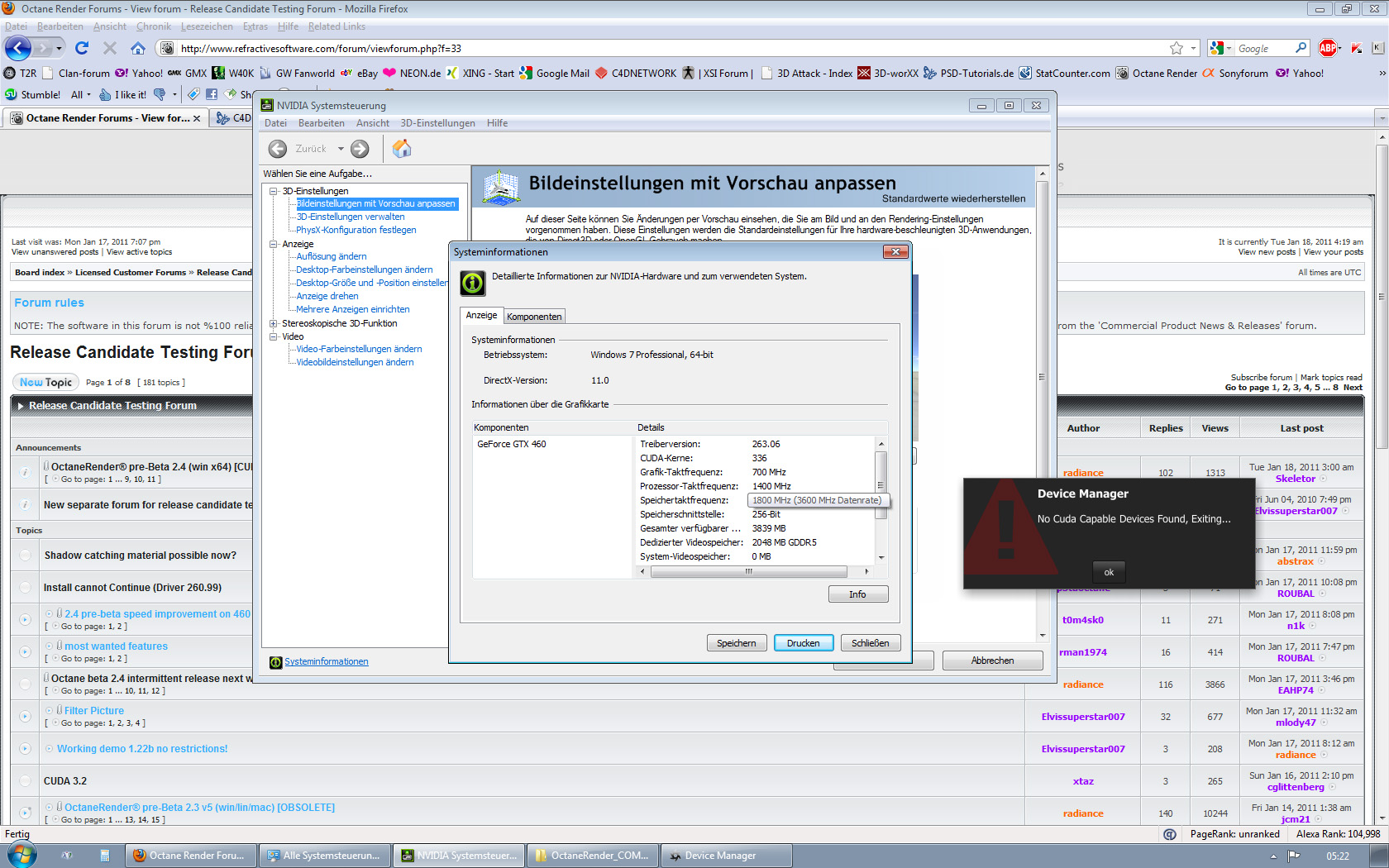

I have an problem with the new octane.
At first, i install the new driver 260.99 and Cuda 3.2. so i start octane.
Here is the screenshot:
So i test the driver 263.06 and i run octane. Its the same. No Cuda Capable Devices found. :(
Here are my instaled drivers:
Whats the problem with my computer?
Edit: If i run octane as admin, Octane starts and run. But, why i cant start octane as an normal user?

katerlake wrote:I have an problem with the new octane.
Maybe try a clean install of the 260.99 driver. It should work - at least it does here. Are you using any other graphics cards? If you are using a Quadro card, please install the very latest Quadro driver (266.45 I think).

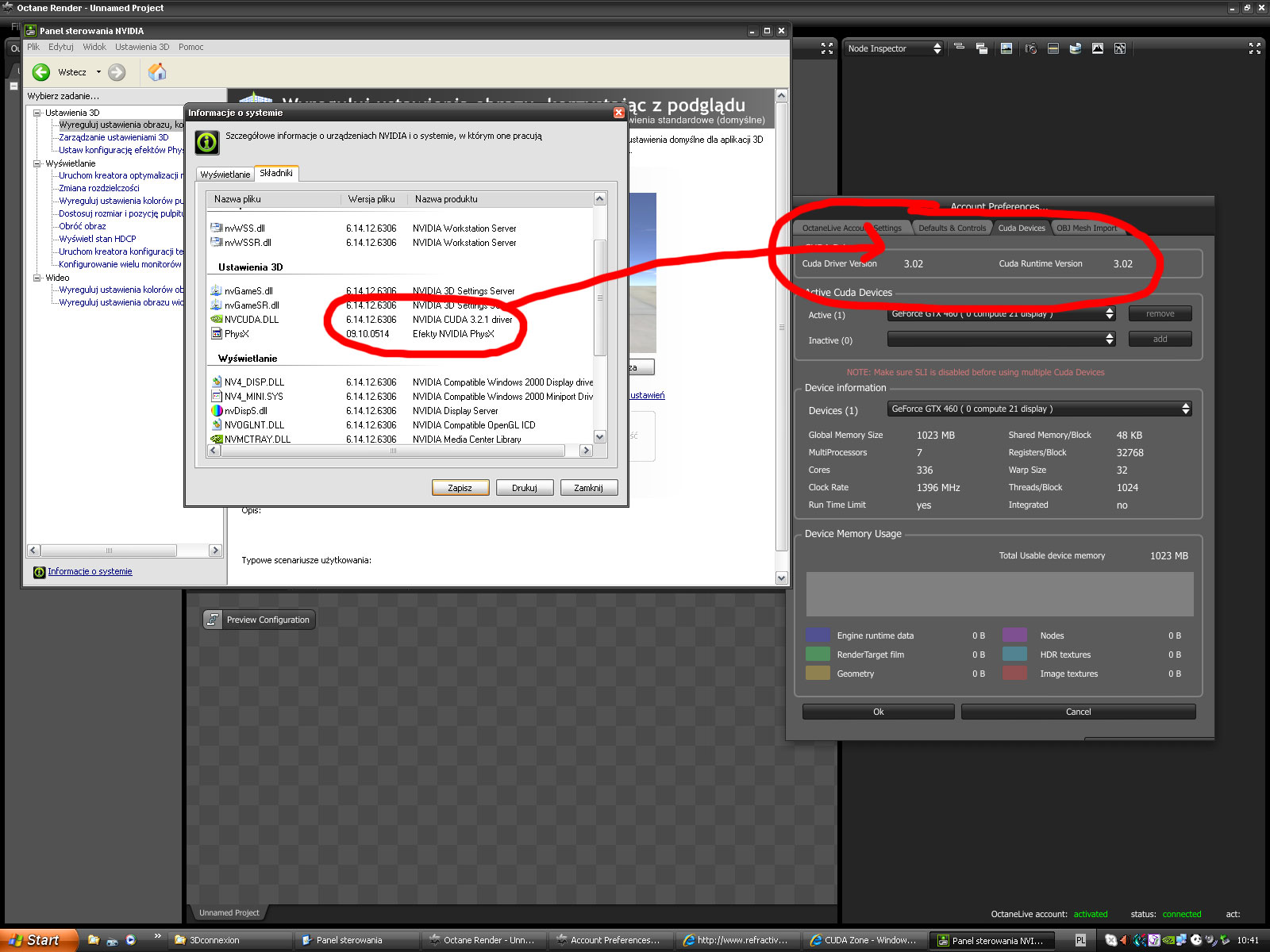

The attachment shoot0001.jpg is no longer available
The attachment shoot0002.jpg is no longer available
i have the same
