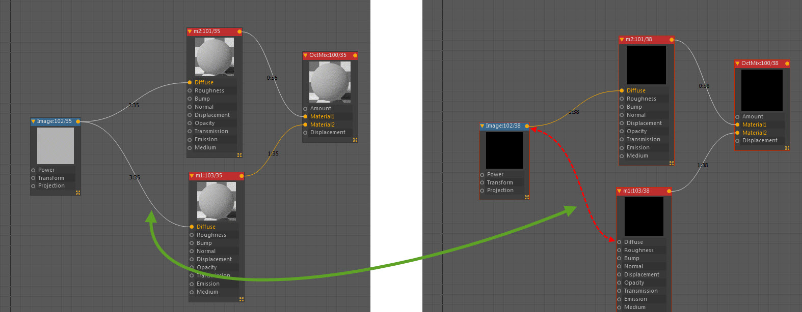

Even if you put every material on the objects (mix and two others) the connections between the materials in the node editor are gone. e.g. a leaf texture with one glossy and one diffuse for transmission material there the diffuse image texture isnt connected with both materials.
do you maybe know a trick for that?

thorwaldhoffmann wrote:Hello there,
there is another problem.
Do you mean this thing as in image?

Super old topic, but I'm having that same issue. And yes, it is exactly like that picture you showed above. Any fix?
Posts: 16068
Location: Türkiye
ktheorin1 wrote:Super old topic, but I'm having that same issue. And yes, it is exactly like that picture you showed above. Any fix?
Super old issue without support. It will be broken if you use one node with two different materials. It's why I created new blend material as alternative.
