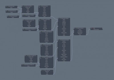

Is there a way to quickly reogranize the nodes of a texture in the assembly view so they aren't all stacked on top of eachother? Just a pain on some of the big livedb textures when I have to go back and move them all so I can see what goes to what...

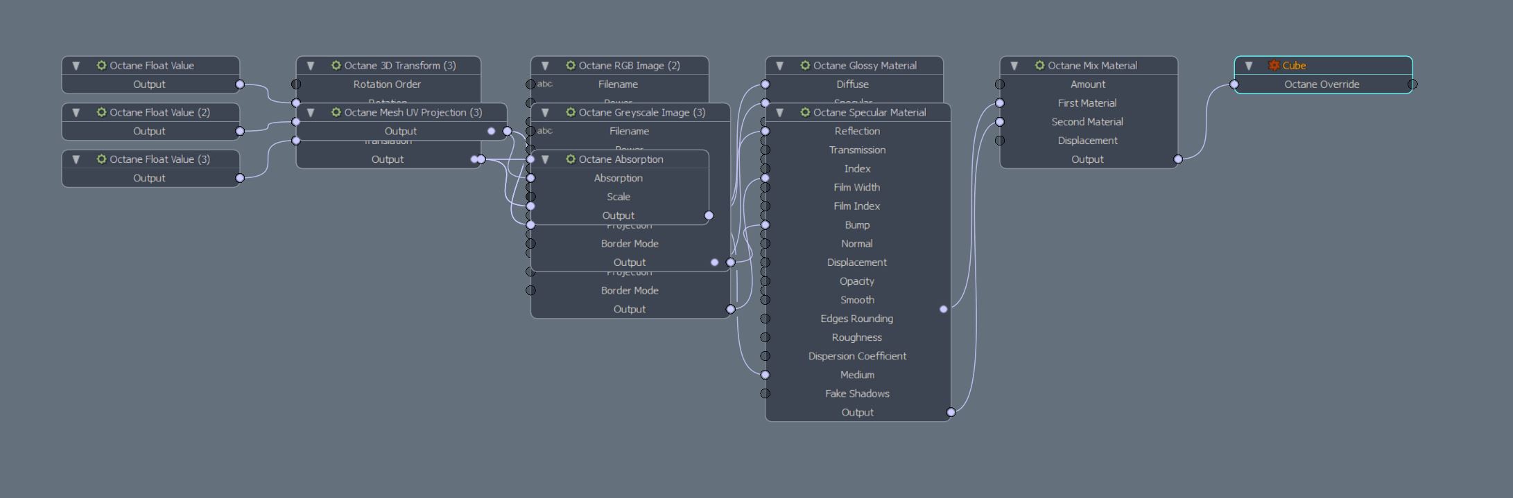

I tried a couple of them. They aren't completely stacked in one spot and have a decent layout. Here are some pictures to post what I mean.
Like I said, not a huge deal. But just something I have to do every time I use a live db texture to adjust the values.
I will add a little more Y offset to each node. The Modo API does provide any means to determine the actual size of a node, so that plugin tries to work it out via a calculation, but you can see it's not that accurate.
