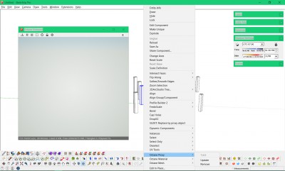

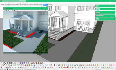

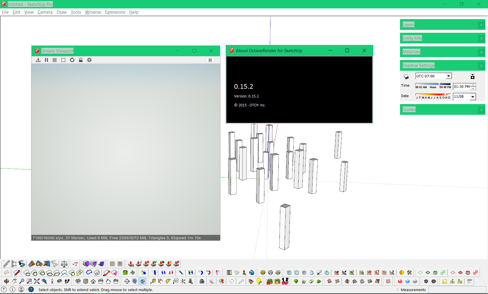

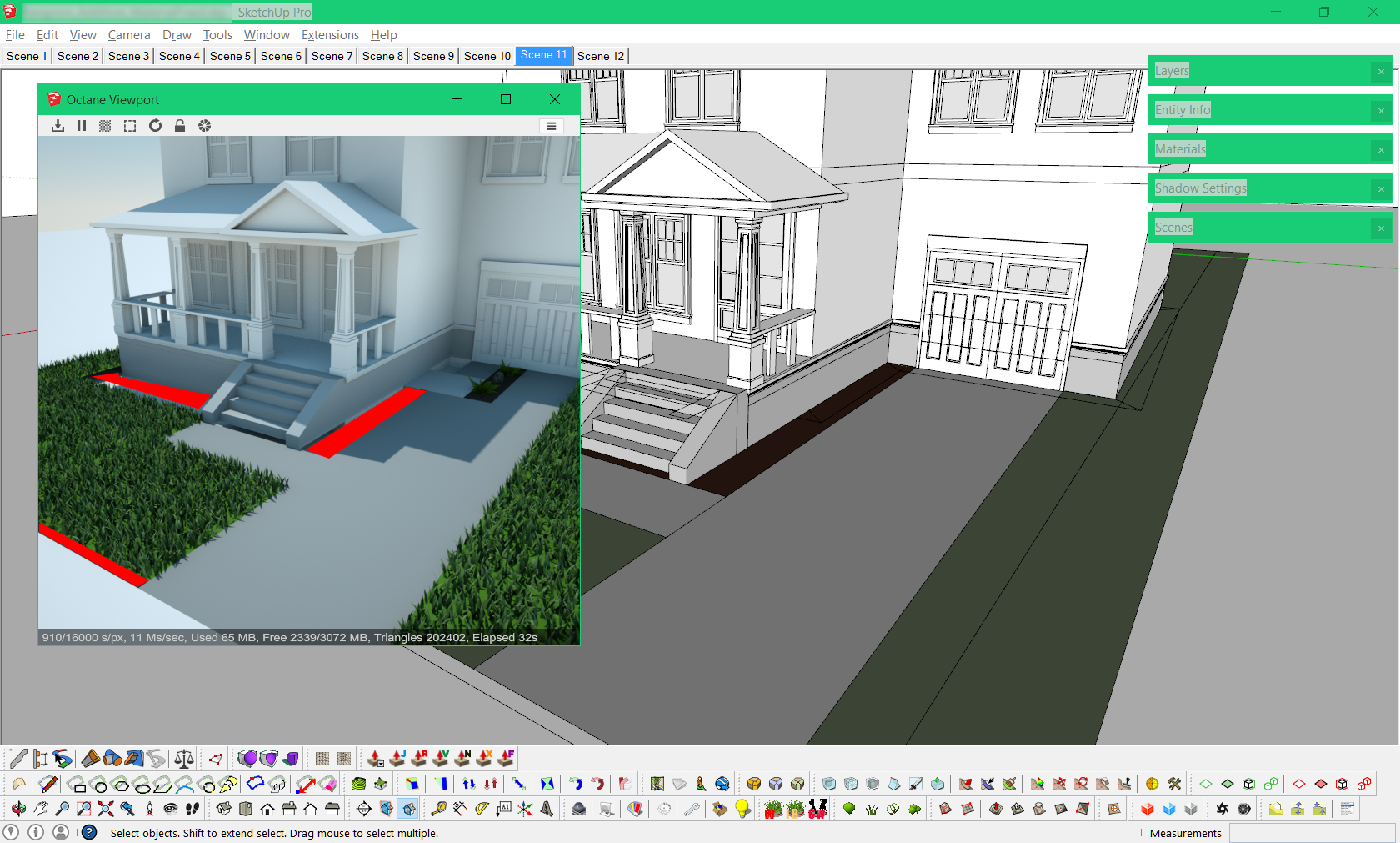

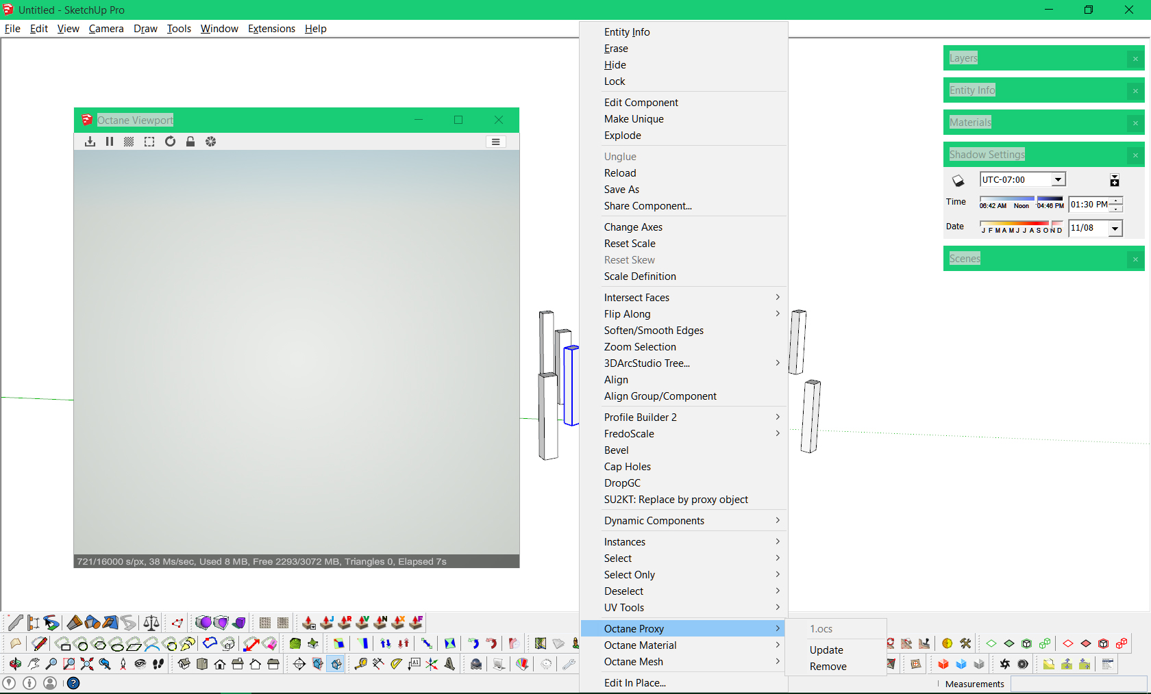

Hoping for success, but still doesn't work. See attached images as the result.
I have 2 solutions for now that work about as well, just not as quickly as one push of the button.
1. Use SketchUp 2014 with v0.13 - Exports *.ocs data perfectly.
2. Obj export by TIG - open in Octane standalone, export *.ocs - proxy attached to sketchup geometry.
*Using the TIG export over the Native OBj export from SU produces much cleaner results. The node tree is named perfectly and includes the materials, where as the su export does not.*
Update no.2 - Now proxies don't even work at all! I apply one I've created from octane standalone and nothing shows.
The only way to move forward remains create proxy data in SU2014
Thanks for giving it a shot.
Update No.3 - Proxies created from SU2014 are still in working order. I've placed them at the origin in export. When I apply the proxies to SU2015 they almost shift origin as if they have a mind of their own. This isn't going well. I have to revert back to pre updates, its affecting my work.
