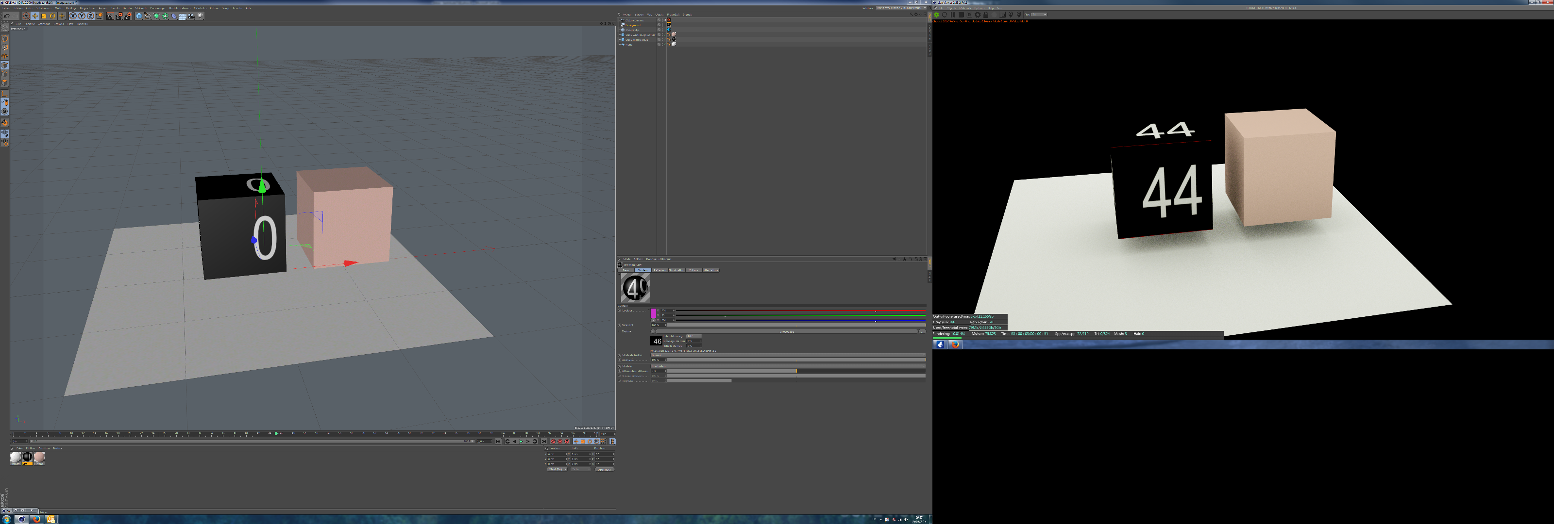

bertritude73
Posts: 21
Joined: Fri Aug 14, 2015 9:33 am
Hi, I opened your test project and thats the result in octane... see picture enclosed
bertritude73
Posts: 21
Anyone can help me to find a solution please ?
thanks
