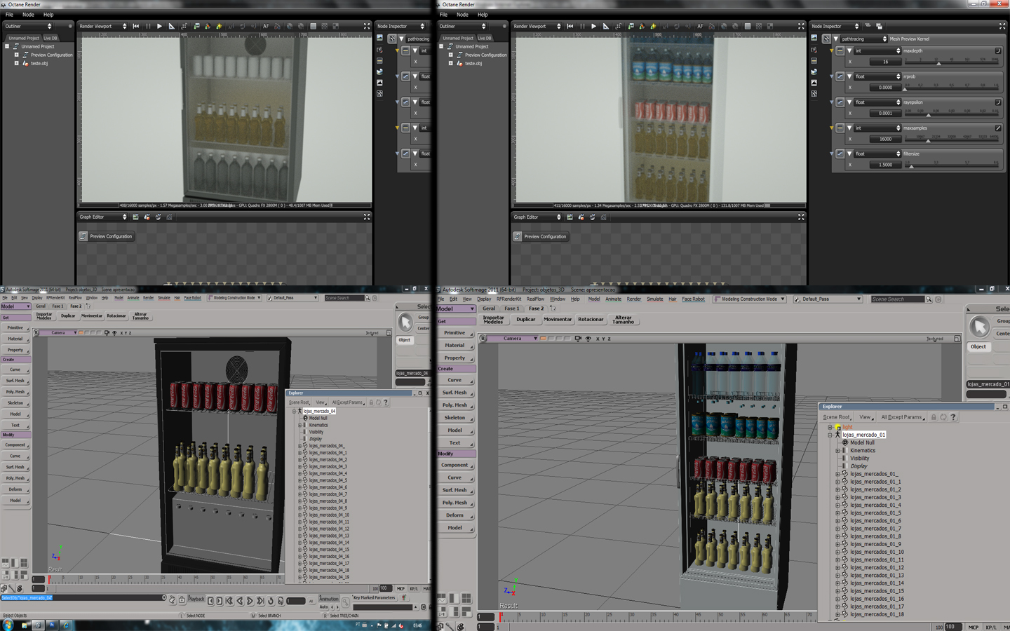

I didn´t made in this way.
The models are exported to octane in independent scenes.
For example, In model_01 I have a freezer with cokes, beers and water.
I export to octane and it works fine.
The I open model_02 that is another type of freezer but has the same cokes, beers and waters, but in this case when I export to octane it didn´t worked.
All the objects are without image textures.
All of this in same project.
Today I made a test, I export to octane models 01 and 02 together and the results are the same. Model 01 Worked and Model 02 don´t.
I already tried to remade the model, rename image texture and nothing.

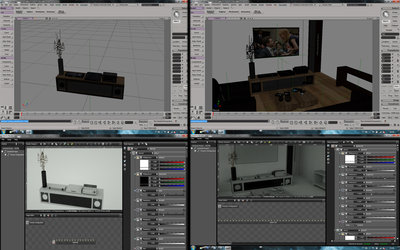

In this case, as the image is showing I have Two models in same project.
In one fo them all the textures works fine, in other with the same material the texture don´t load in octane. I´ve tried to create a new material and nothing.
In this project I have about 2000 models and this case is happening with 35 specific objects.

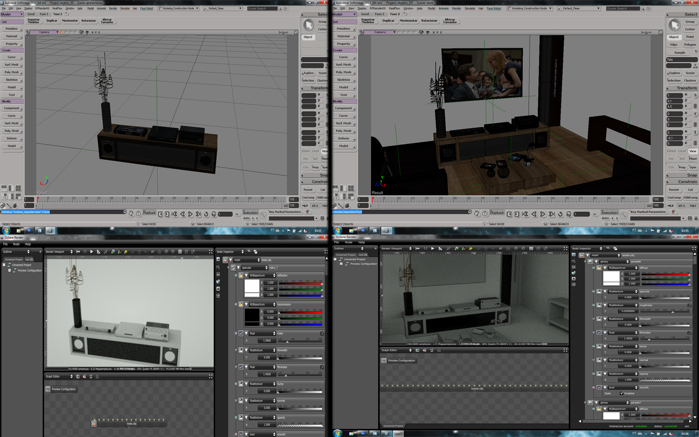

Case 02:
This is my biggest problem, I made this project to test the time of interior production and all of it works fine until now.
By now every model in this scene don´t open the textures in octane. I have two licenses from octane and I tested in two differents cpu and the errors are the same.
This is different of the case 1 because in that case the model never worked, but in this "case 2" it always worked fine in my two computers.
I´ve tried to build this project in a new scene, in new project and nothing. it simply doesn´t work anymore.
Can you help me with this please?

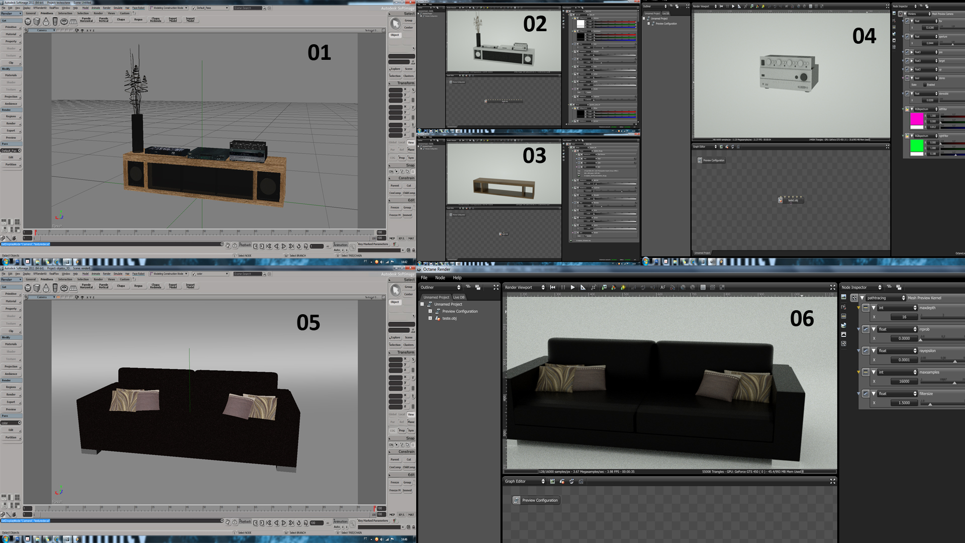

Hi Face,
I put a image below trying to show the problem more detailed to you.
01 - This is one of my models that I was using in my test project. Everything was working fine, but suddenly it begans to not work anymore.
02 - This object don´t read the textures anymore, only shaders. I´ve tried to use it in new projects, always overwriting the last export too. The funny and strange thing is: Don´t work anymore in my two local projects in 02 different machines.
03 - Here what happens if I export only the rack with wood texture. It works.
04 - Than I tried to exported only the receiver and don´t work.
05 - This is the couch I used in my test project, in project doesen´t work anymore too.
06 - Here what happens If I export only couch, in this way it works, fine.
The most of my other models, are working correctly. But, as I said to you this is my biggest problem because all of it was working, and no more no less stop to working.
