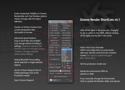

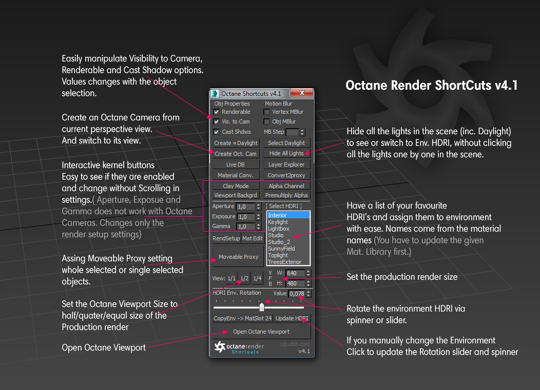

Check the below image for better understanding NEW UPDATE v4.3

What is new :
- You can now toggle Clay mode, Alpha Channel, Premultiply Alpha Chan and Viewport Background with a single click.
Using Checkbuttons will also let you see if these settings are enabled at that point or not.
- Also you can adjust the Aperture, Exposure and Gamma setting on the fly. they work without a lag.
And update the value to the render settings once you let go of your mouse button. There is a bit of a lag once you make changes in these values.
Because it updates the scene render dialog box. If you close the Render Setup window there'll be no lags.
- Another great thing about it is that you can now set the Octane viewport size to equal/half/quarter size of the production render size, instantly.
Which I thing it's great when dealing with large scenes.
- I dropped the support for creating targeted IES lights. Because there are issues that needs to be addressed with the core of standalone and also max plugin.
So once the targeted IES lights are introduced. I'll add a button for it.
All other buttons are pretty straight forward. And you'll get used to it in no time.
