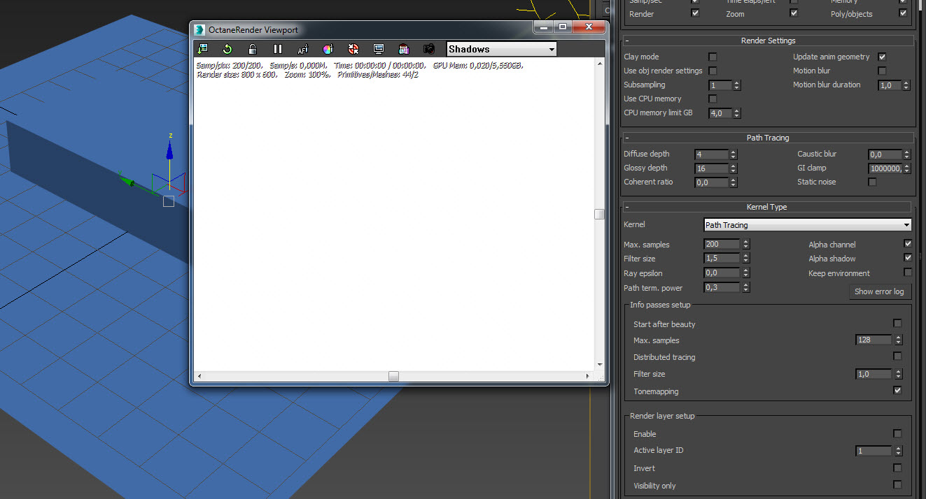

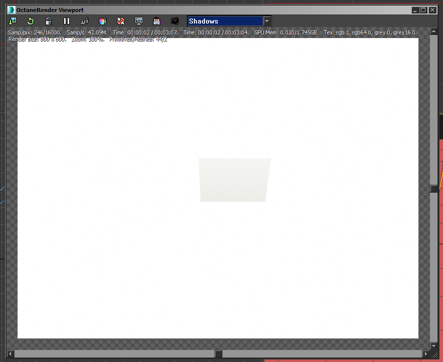

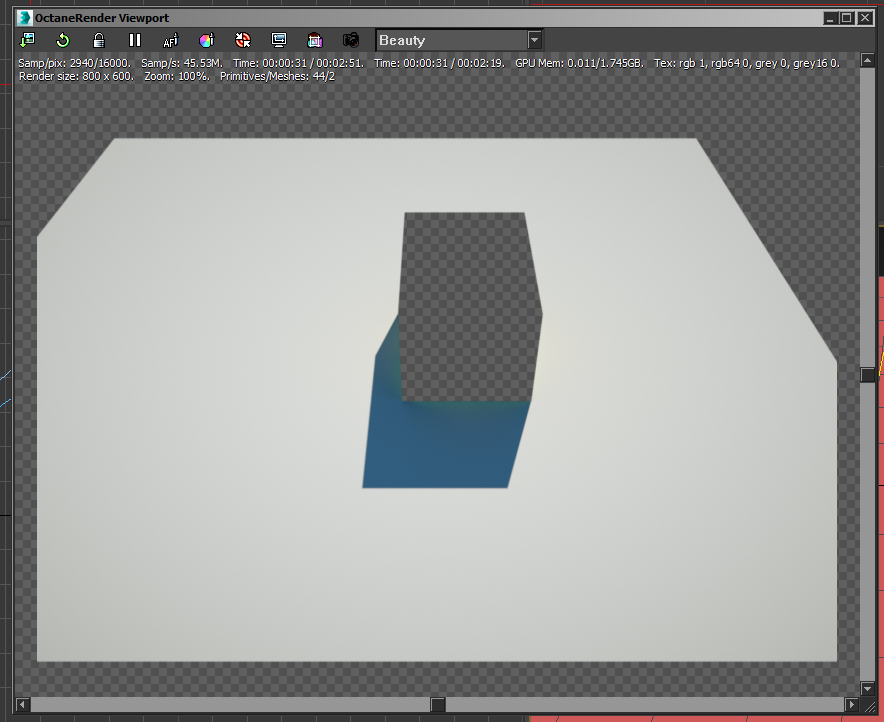

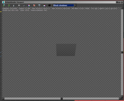

How can i get pass Shadows? I have white image when select Shadows chanel in octane viewport
Shadows
Shadows
Beauty
Beauty

Me, too, i only get a white image!
What is it with the Shadow Render Layer?

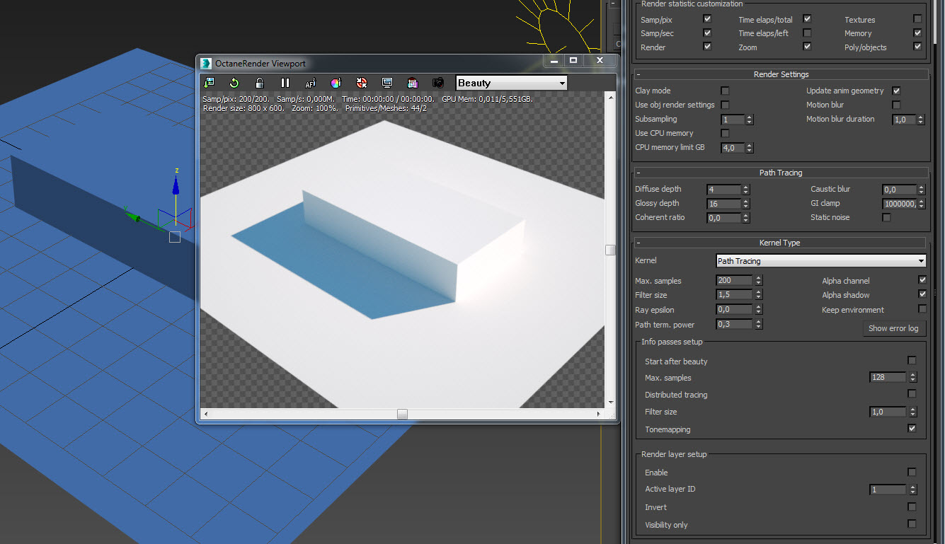

You need to enable Kernel->Alpha Channel for the shadow passes to work. https://docs.otoy.com/#51Render%20Layer%20Passes

Thanks Paul, But how do you do it in 3dsmax octane plugin ?

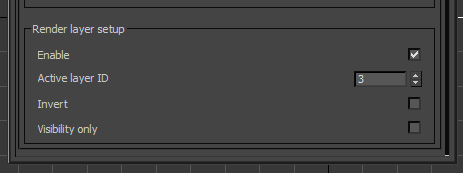

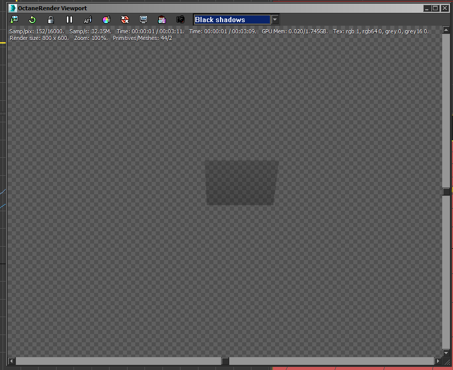

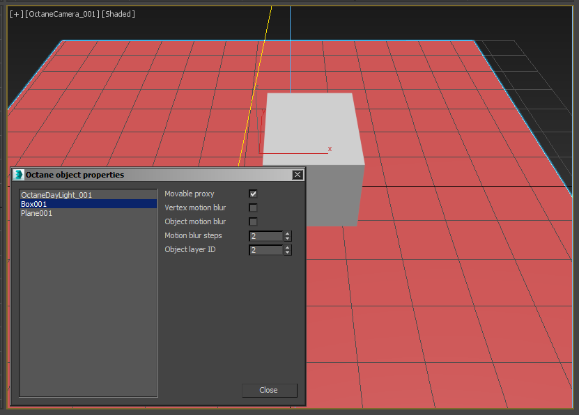

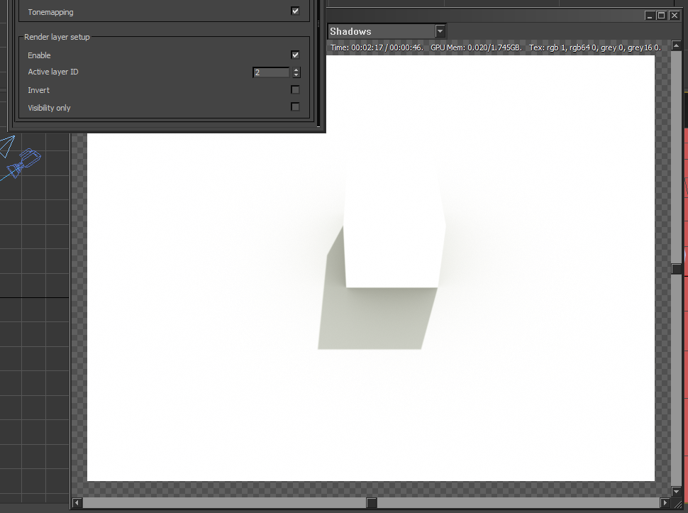

JimStar

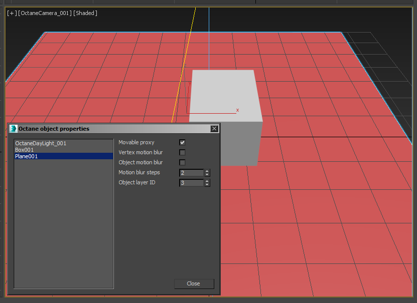

Posts: 3852
The same as in standalone.
You assign the different render-layers to objects of interest.
Enable the render layers and set the needed active layer (what exactly - depends on what result you need).
Get some result.
Change the active layer if you need the different result.
