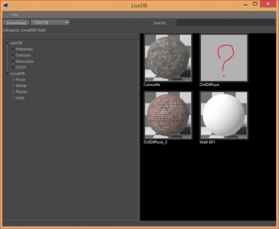

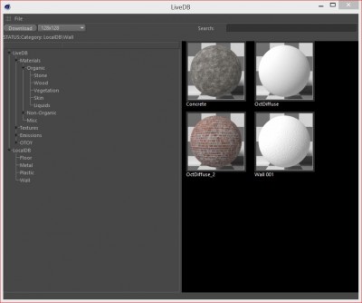

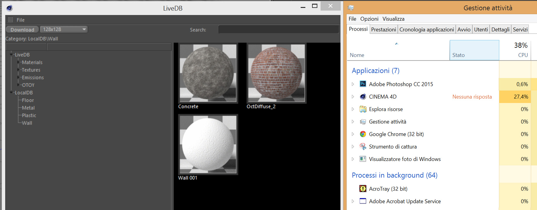

I have encoutered a problem when I drag a material on LocalDB window, C4D hangout! So Ctrl+Alt+Canc is the remedy.
When I restart C4D the material I have dragged on LocalDB is present, but no preview available.
The older material has the previews.
WIN 8.1 64bit - Nvidia latest 353.62 driver - C4D 16.050 - O Standalone 2.24 plugin 2.24.1
is it reproductable? If so pls give me this material.augdalmo wrote:Hi Aoktar,
I'm checking. New sdk can have a problem, codes ares same on plugin side.
But please post this kind of reports on related topics. Ex. in 2.24.0 release topic. Because it's not common issue and causing unnecessary confusions for me and other users.
