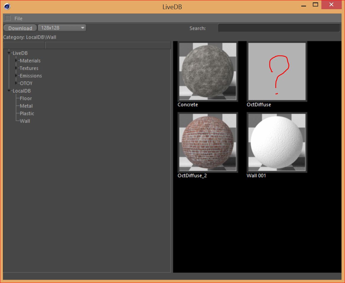

I have encoutered a problem when I drag a material on LocalDB window, C4D hangout! So Ctrl+Alt+Canc is the remedy.
When I restart C4D the material I have dragged on LocalDB is present, but no preview available.
The older material has the previews.

Hi Aoktar,
it occur for any material, diffuse o glossy, even the simplest, ie without texture or shader.
On the picture a diffuse white material (default)

Hi Aoktar,
I think the problem is in the 2.24 version. I have now installed 2.23.2 R6.1 an it works pefecty!
