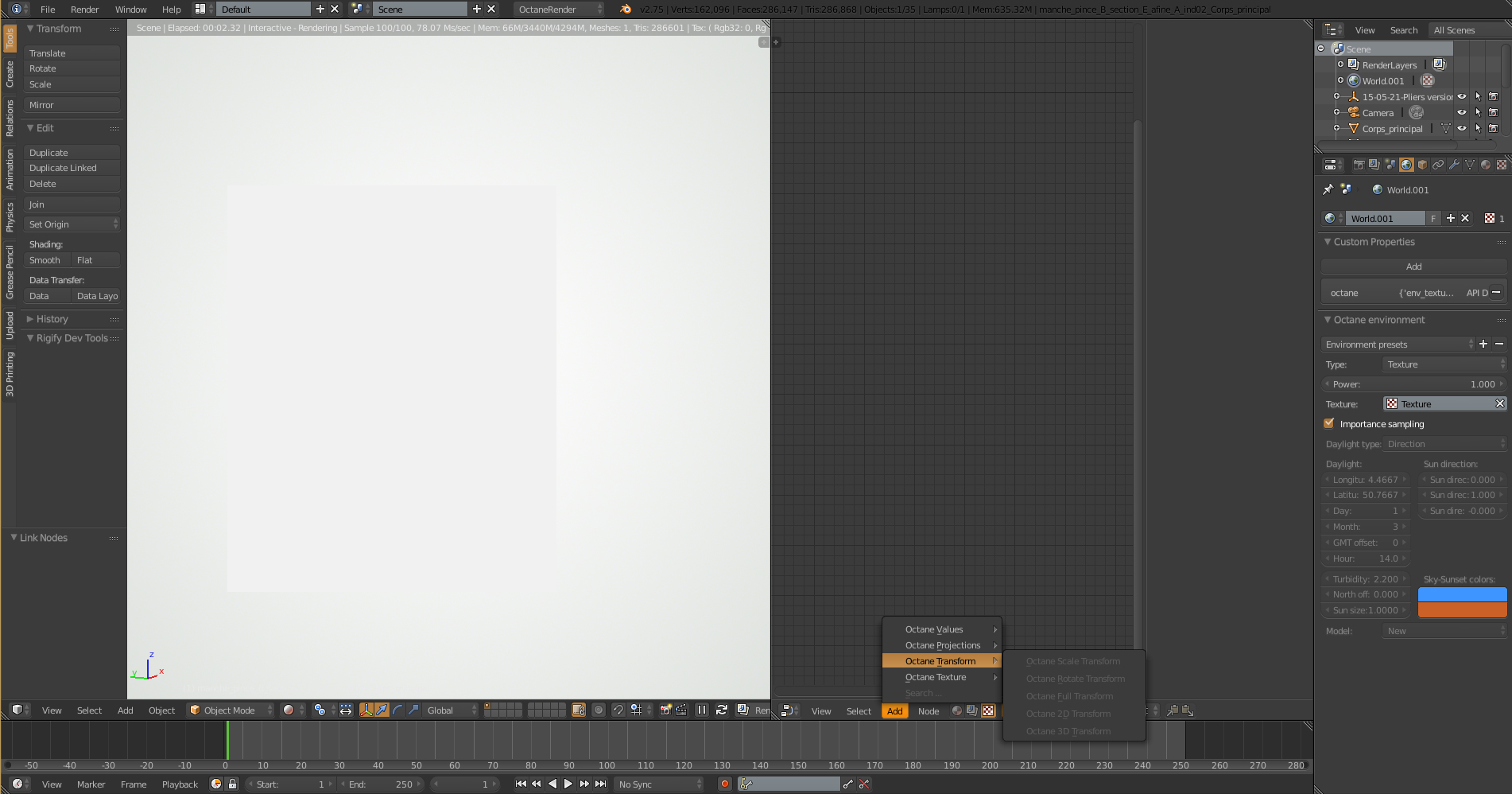

I sourced this youtube video from MTimtam if you look at 3:35 that is my problem. I can't actually load a HDRI map?
Is this still the case?
							Thanks for your reply, I get how to activate and deactivate the license now:)

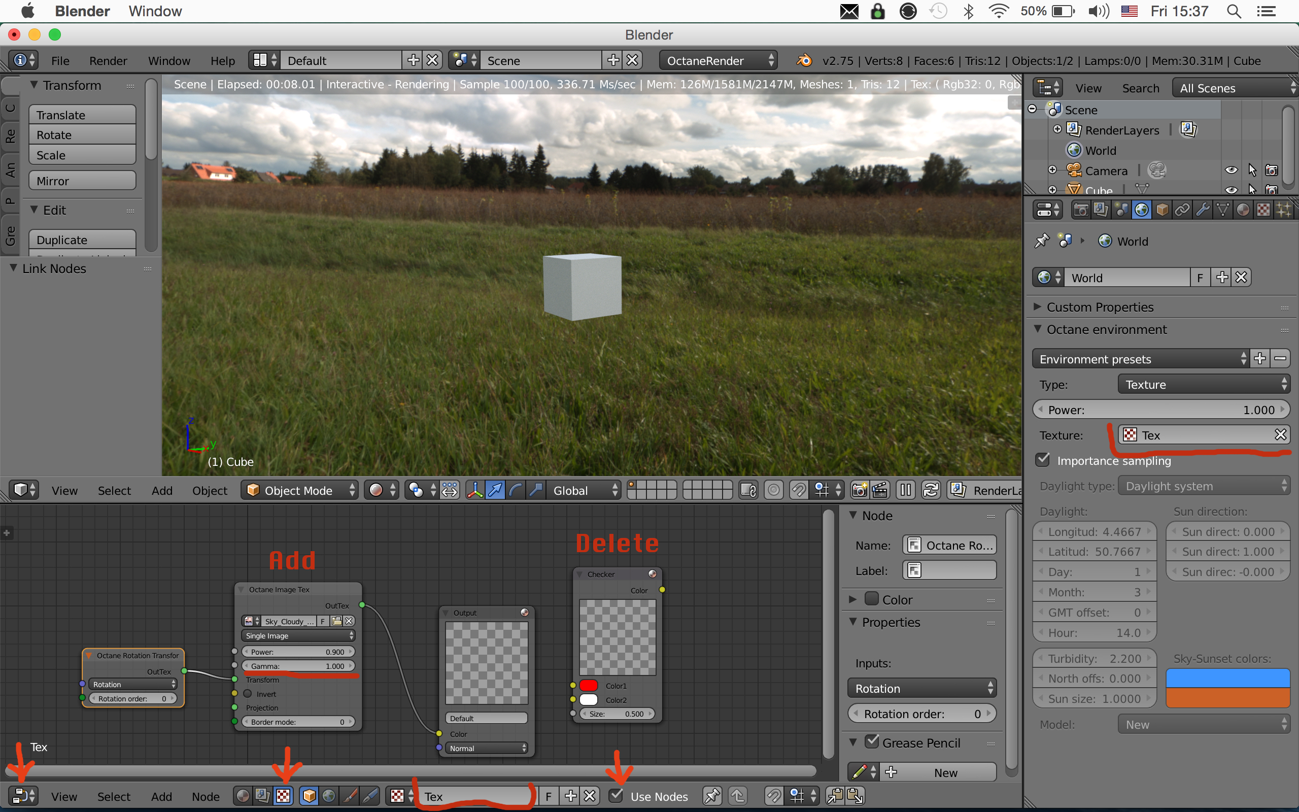

Hi Saramary,
Thank you, thank you. I was actually using the Shader Node Tree instead of the Texture Node Tree, that's where I was getting confused.
A big THANK YOU! too you all I know this stuff is basic but you really helped me tremendously
