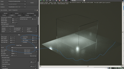

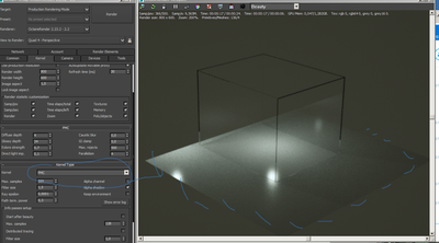

JimStar please explain to me why the right reflection are considered to be longer on the floor

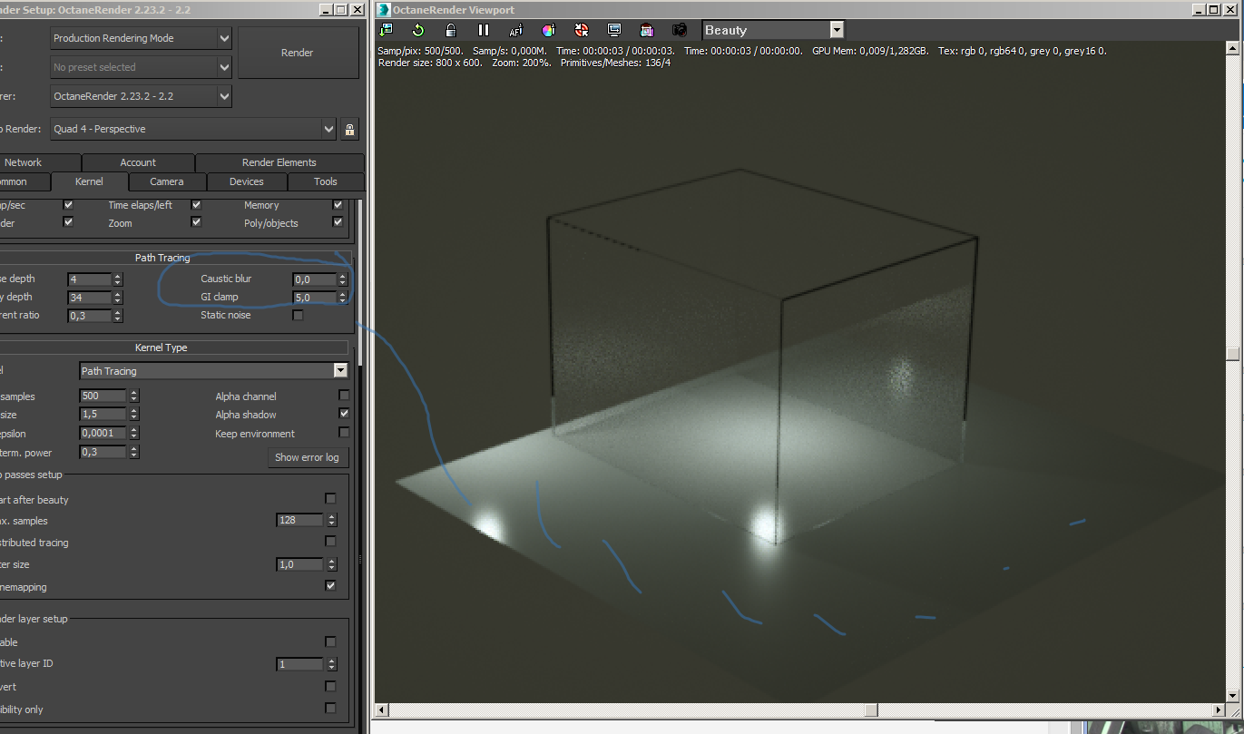

this is a mistake of the lights will not help even 64,000 samples
We checked in the standalone version of the same problem, glass octane with a bug it's a fact!
We tried everything
caustic blur 1.0
clump 50
coherent ratio 0.3
I can not do anything to correct the situation

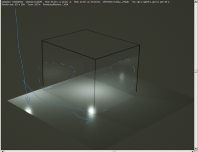

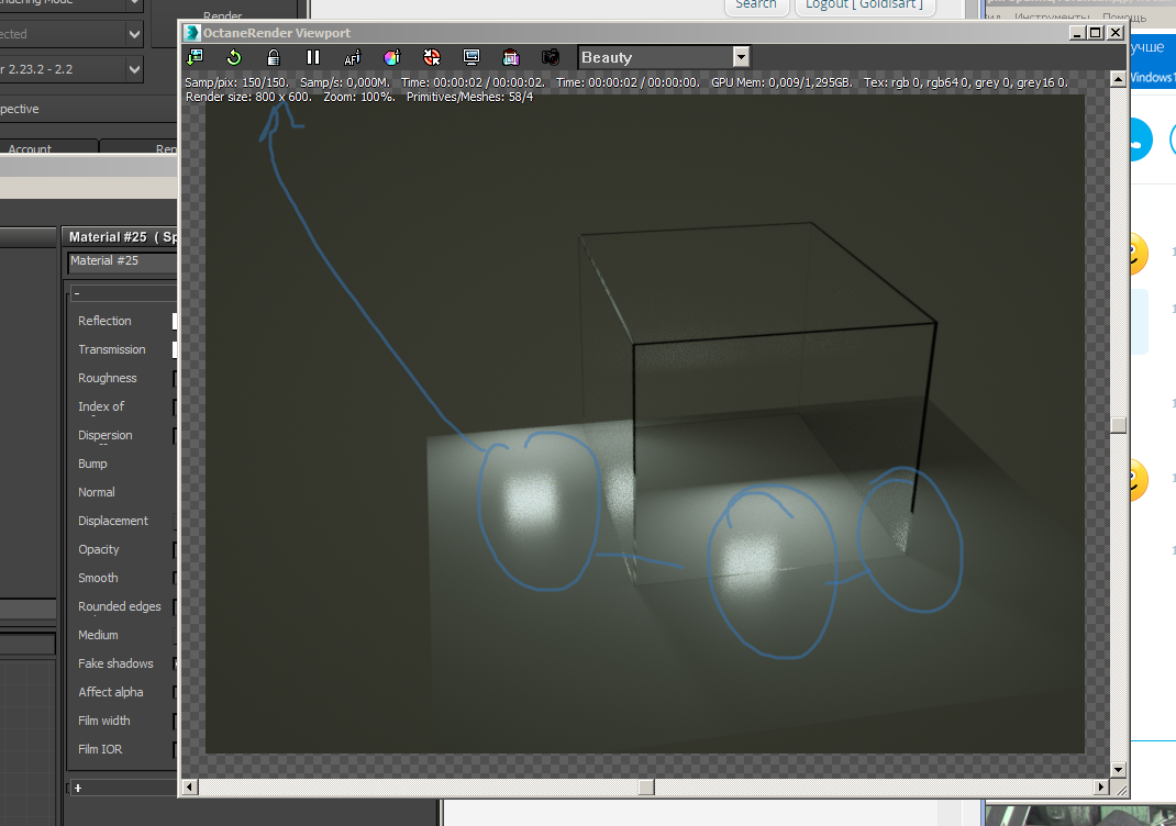

it's not the thickness of the glass - here is the picture where plain used as glass

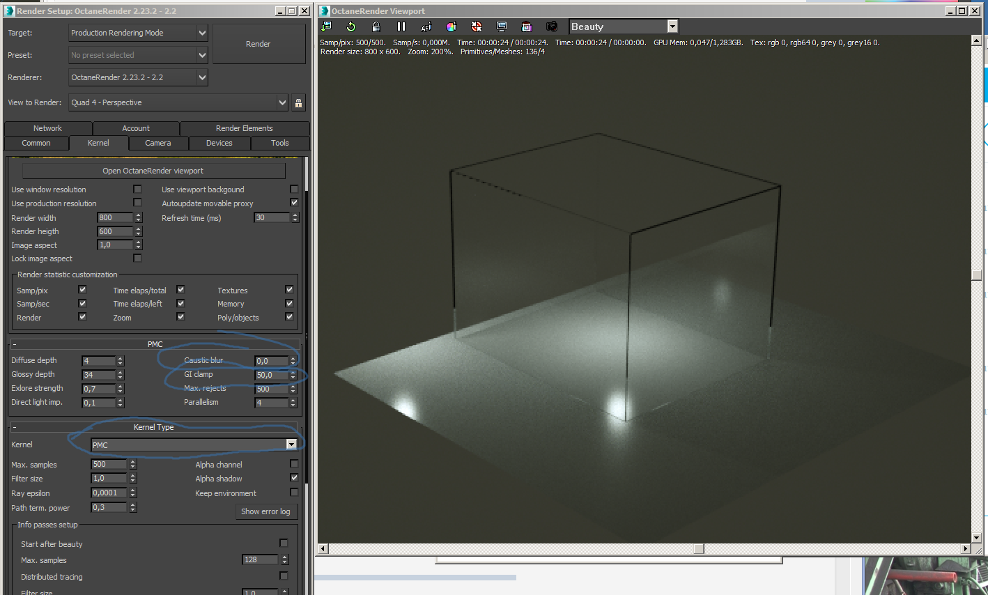

I think this is a feature of path trace kernel, not a bug. enough to make light not visible and picture will be noise free. or rendered with pmc kernel.

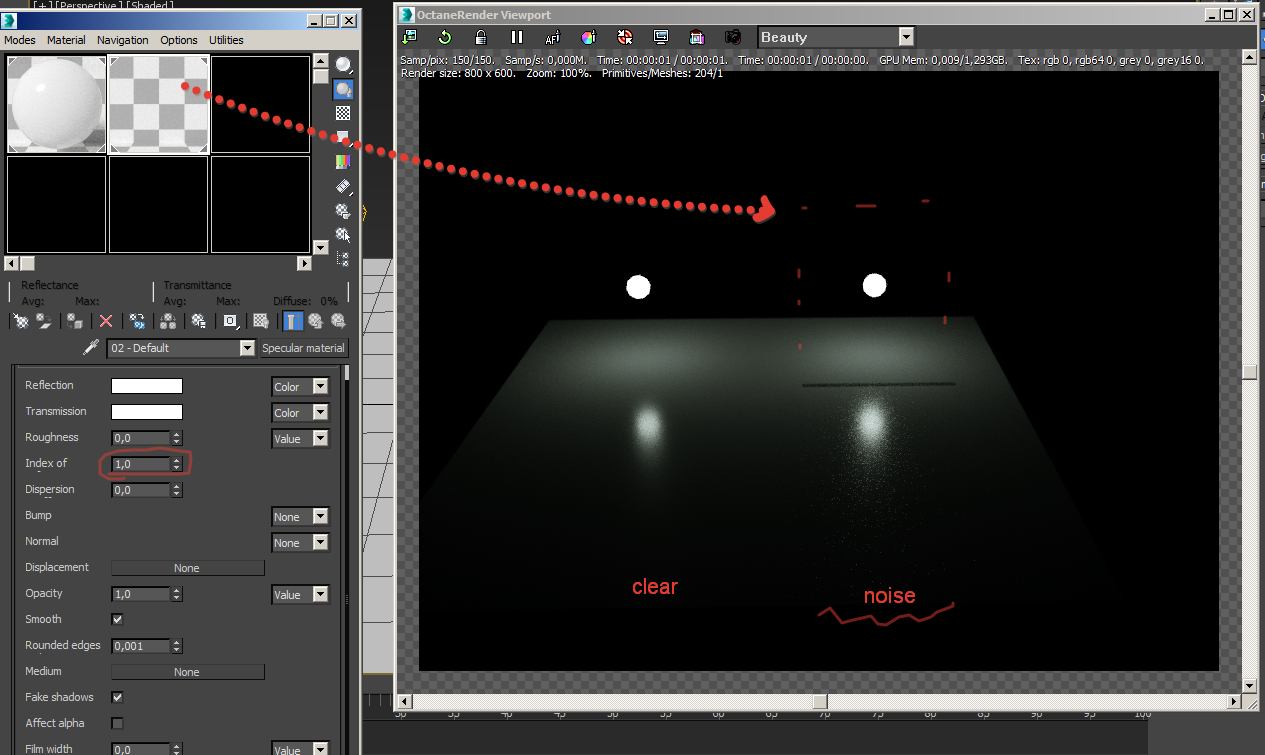

Definitely !!! all light - all objects NEED to be transferred to MOVABLE PROXY/ because object is not translated these errors. Thanks to all who helped
I hope the developers will remove the exception since many probably do not know about the mandatory switch to movable proxy and it is because of this there are excess light noise\

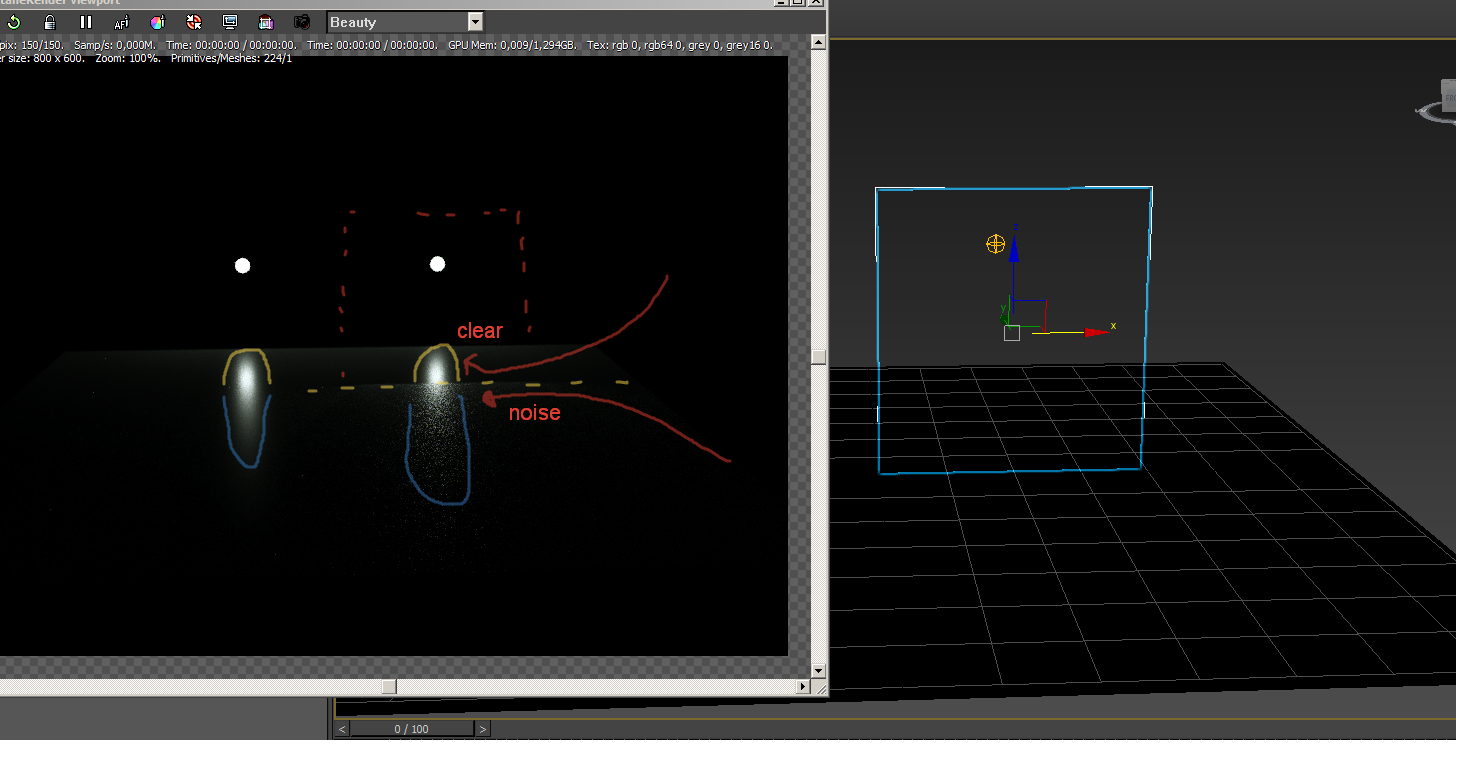

can your example to see? to me it didn't help. noise in channel reflection indirect. weird if you helped checkbox on movable proxy.

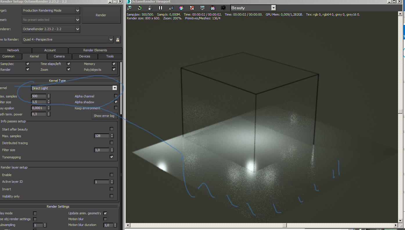

the noise disappeared ===
them exactly as much as it should be at 150 sampl/pix everywhere

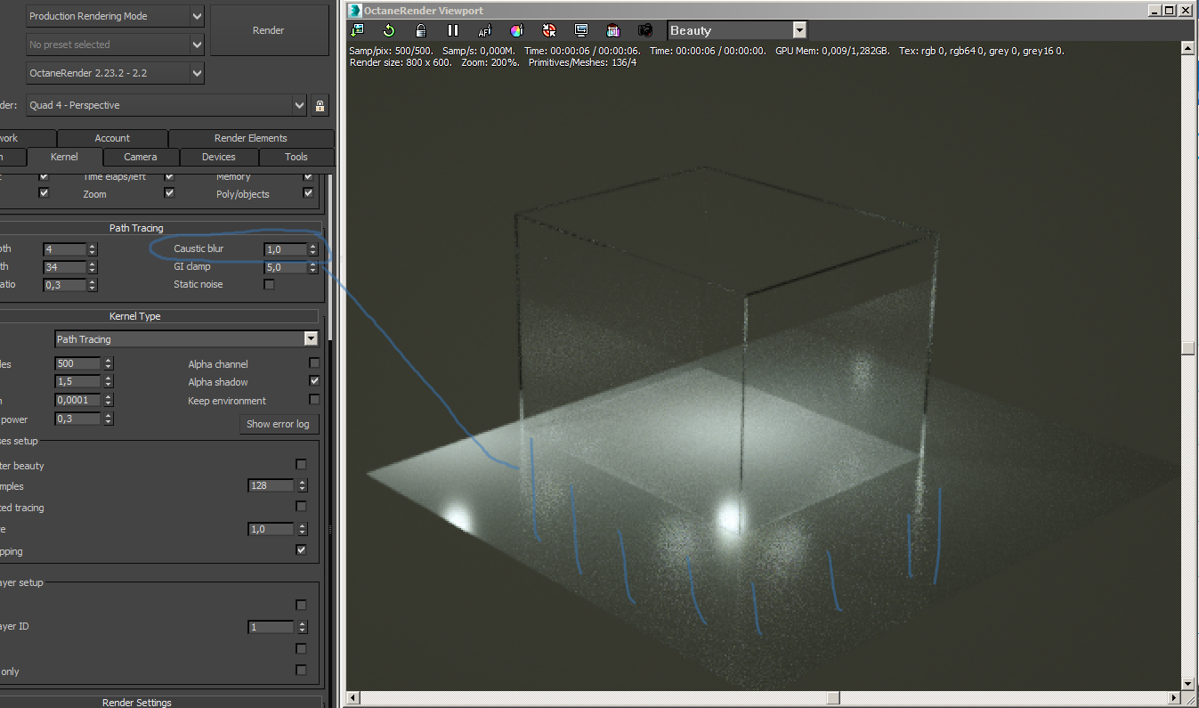

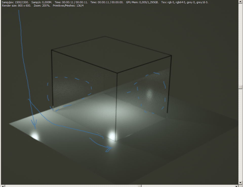

no I rejoiced too early - inside glass gloss not disappears...
through the glass problem is solved by turning off visible light source

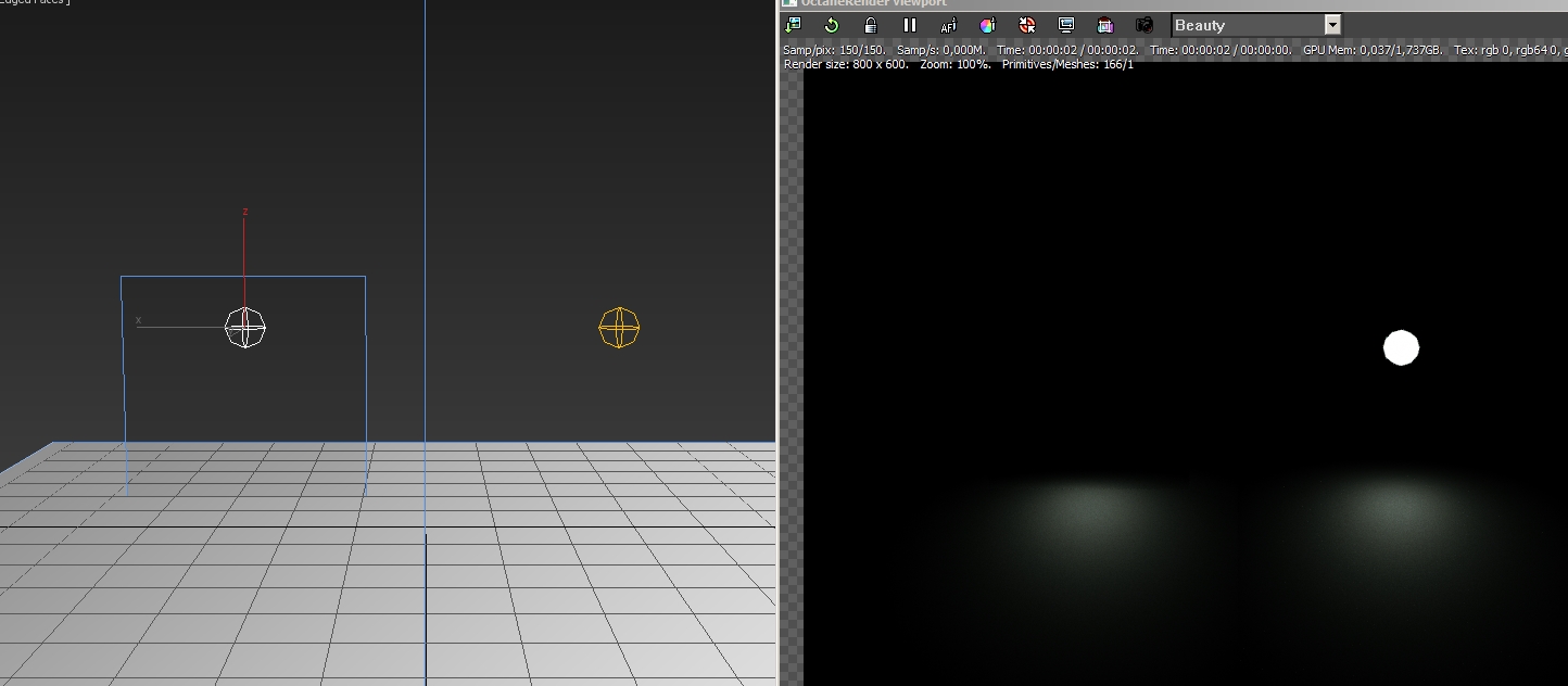

thinking out loud

Other options clean render I not found
at it's worst output time . time for interiors high resolution. Doubt Distribution Render or Video cards
