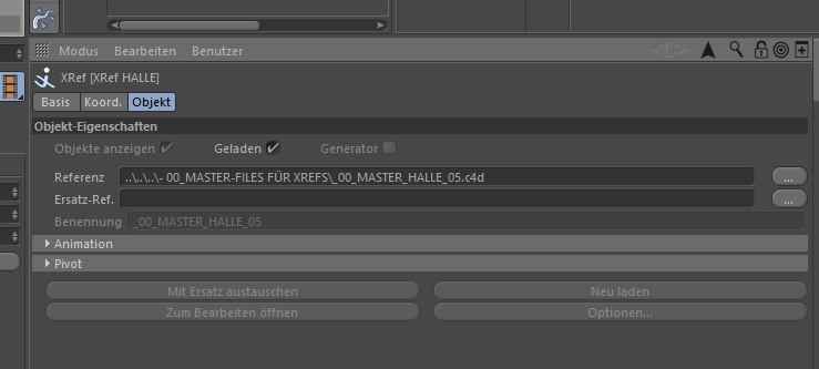

I want to use Xrefs in a complex scene. I hold a master file and reference it to different other scenes.
But when opening such a scene the Xref can't be reloaded because the attributes are greyed out.
I don't know if this is related to Octane plugin. Does anyone else having similar problems with Xrefs?

Have you tried without Octane installed?

Hello Ron,
I use XREFS a loot with octane, very heavy scene with many expresions, materials and characters, I did't find any problem so far.I hope that you will resolve your problem. Cheers.Alex

aoktar wrote:Have you tried without Octane installed?
No - not this time - but I didn't have problems with Xrefs in pre-OR-plugin-times.

creatorz wrote:Hello Ron,
Interesting!
Need to dig deeper into this - maybe something is wrong with file paths.

Fisrt time i'm trying to use Xref with Octane today. Hq grass. i can see the objects and render geometry but textures neither simple color shader. so the materials are not taken into account. but when i try to render the file everything is ok. any idea?
ps. all the materials are AR

Hello,
Did you check option under Xref ?

creatorz wrote:Hello,
Couldnt get the option you're talking about?
PS. i see all the textures and colors in editor but render. :roll:
