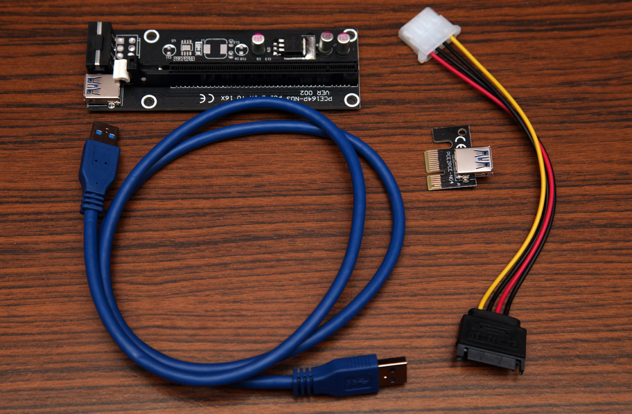

But get a riser like this, and connect via USB 3 and a a external PSU don't work?

..this is very simmilar option, but as You see USB cable is used only to conect mPCIe with PCIe.
as far as I know, GPUs don't work so well via USB (if You conect to where You typically place flash/mouse, etc..)
- but this field always evelve & there migh be a solution..try do a bit of research =)

in Your case, as offerend one of the best deal woud be to get a mentioned kit with mPCIe conector, relocate Your wifi module (from mPCIe to USB - simplyu get cheap dongle) & conect Your GPU into mPCIe.
Would it work 50/50 (do Your homework before or simply get the kit & try out for Yourself). So there are solutions - You just need to spend Your time (or more money before making a decision to get laptop).

can you explain by image this option?
I like to undestand better...

I posted your image but i don't undestand very well how work it...
How do I connect to the laptop?
