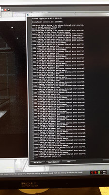

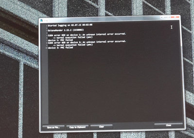

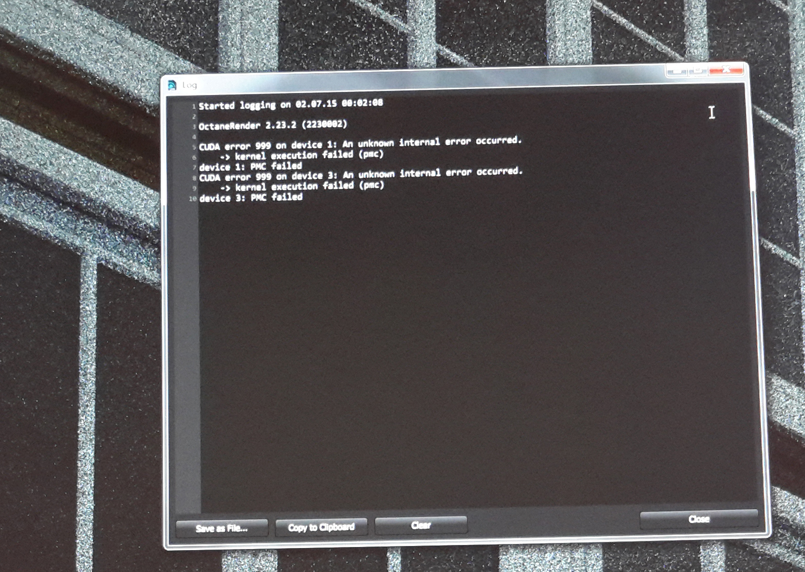

I start my render this scene, whether this in PMC, path tracing or direct light,
and at first all is well with no problems, however after a while when the yield reaches about 20 samples
the monitor flashes and appear some error messages (pictures attached) ...

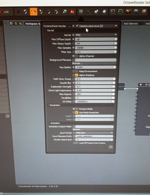

I'm using 801 SP3
I tried to render into the octane plugin 2_21_1_53 and 2_23_2_78

Some more details on this issue...
1) Yes, your scene is causing an error 999. I believe this error is coming from the slave (you can see the cuda error on the slave PC terminal window). I appears to be related to a particular texture. If you export to ORBX, load into Standalone, and try to network render there, the upload process gets stuck at 147/746MB, so I think something in that scene (a texturemap?) is terminating the upload process, resulting in the error 999. I have uploaded the ORBX to the Otoy devs to determine the exact problem.
2) Yes, after this error, loading the scene into Octane only loads a partial scene. I have never seen this before, and have no explanation! Clicking the Refresh button seems to fix the issue.
Thank you for all the info you provided.
Paul
Paul
Hi Rafael - The Otoy devs believe that the error 999 is due to the slave PC Nvidia time-out settings. Pls see http://render.otoy.com/forum/viewtopic. ... 68#p214968 for details. Can you pls install Octane Standalone 2.23.2 via the installer EXE on all your slaves and try again?
