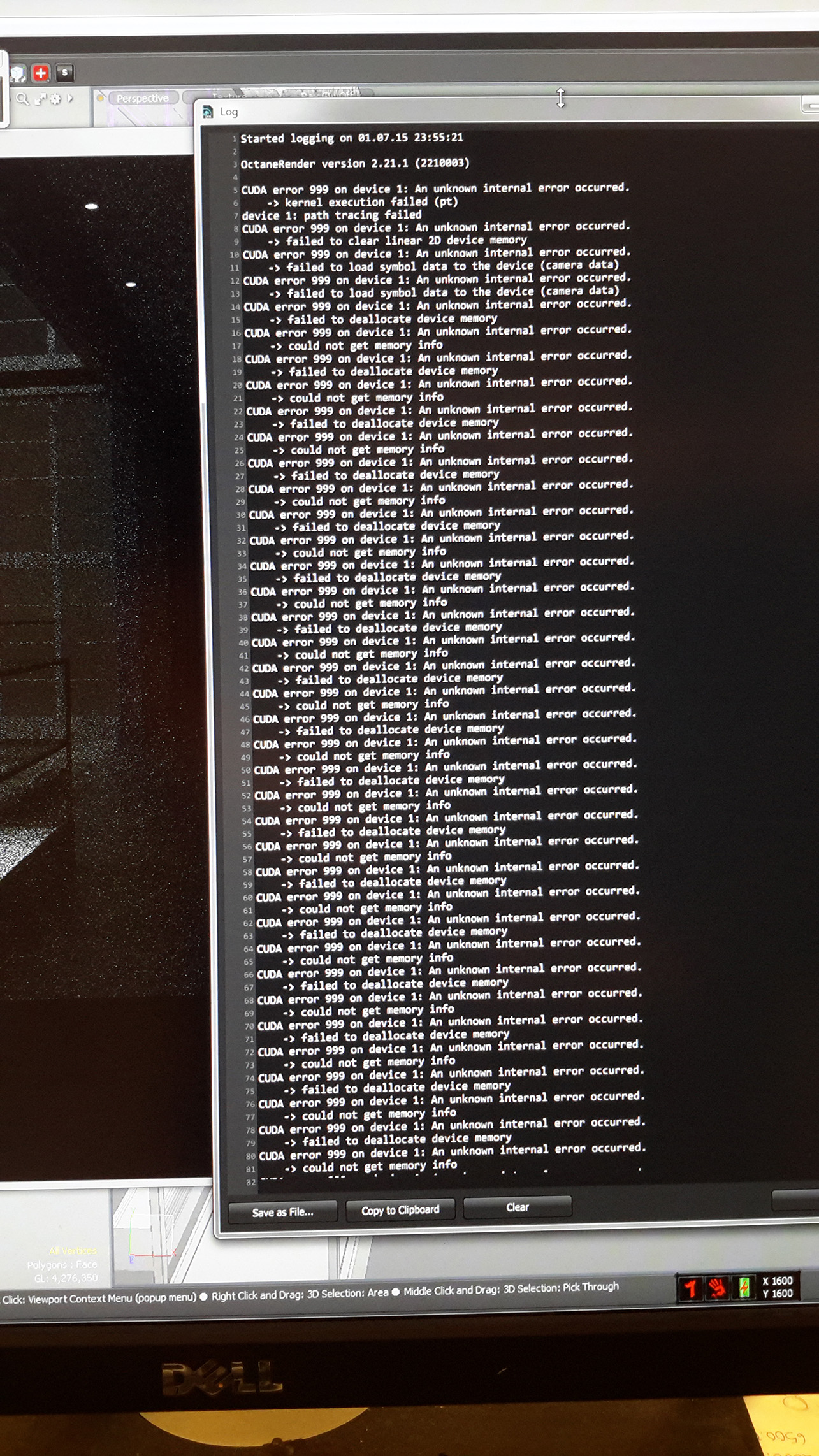

Hello friends of the forum, I'm having an error that taking my sleep of (literally) ...
I start my render this scene, whether this in PMC, path tracing or direct light,
and at first all is well with no problems, however after a while when the yield reaches about 20 samples
the monitor flashes and appear some error messages (pictures attached) ...
I'm lost because I tested the same scene in 3 different computers and the same error occurred in the 3,
another thing I cannot understand is why it also begins to render normally and suddenly the error occurs.
The drive from my video card is update with the latest version (I tested on computers with Titan and Titan Black)
since already I appreciate the help
error 2
error 2
error 3
error 3
error 3
error 3
error 4
error 4
error 5
error 5

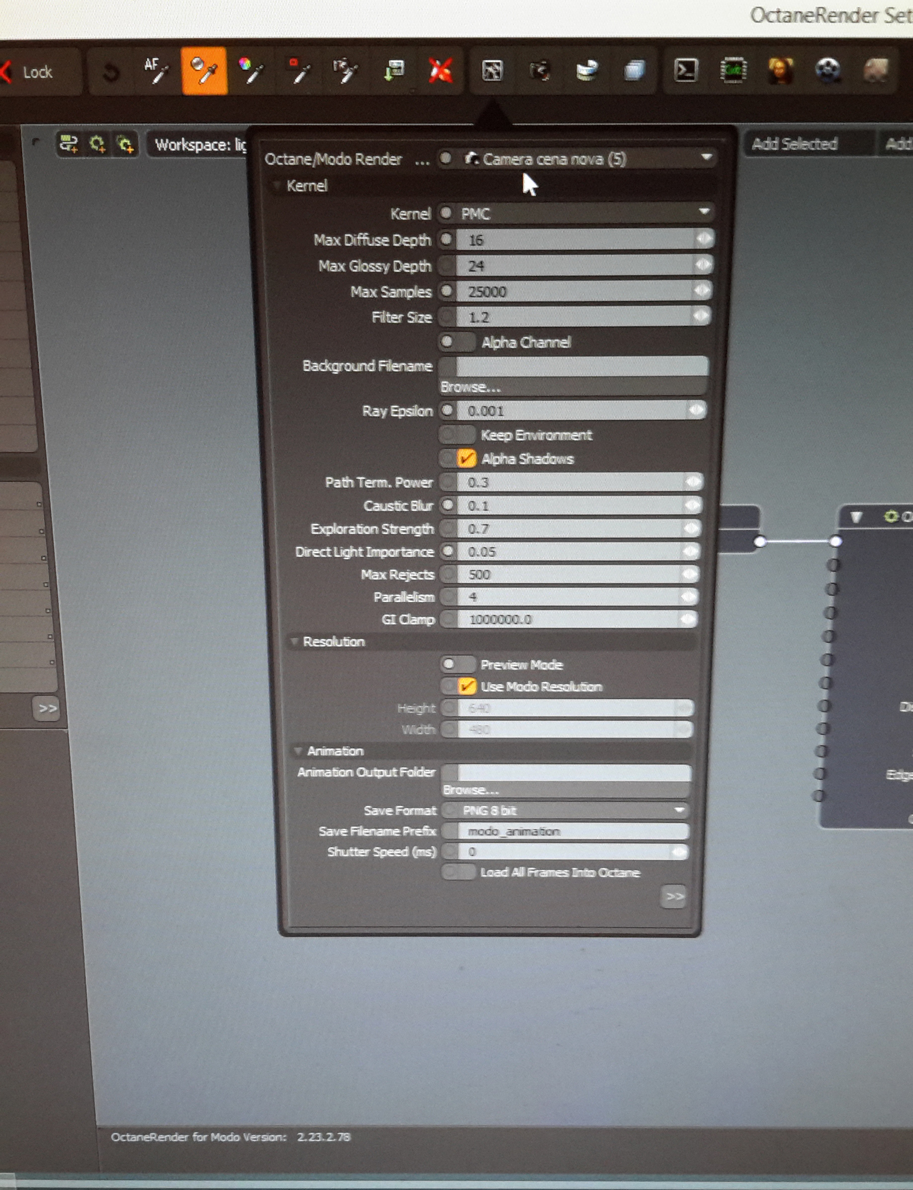

Last night I testing numerous times with different versions of the plugin (2_21_1_53 and 2_23_2_78) and 3 different machines, follow the specifications:
-1 Computer with 4 Titans
-1 Computer with 4 Titans Black
-1 Computer with 2 Titans Black
in all computers I used the last version of NVidea driver, the 353.30 driver
I test with daemon on and daemon off.
I'm using displacement on the ground.
The video cards are stock speed.

Some more details on this issue...
1) Yes, your scene is causing an error 999. I believe this error is coming from the slave (you can see the cuda error on the slave PC terminal window). I appears to be related to a particular texture. If you export to ORBX, load into Standalone, and try to network render there, the upload process gets stuck at 147/746MB, so I think something in that scene (a texturemap?) is terminating the upload process, resulting in the error 999. I have uploaded the ORBX to the Otoy devs to determine the exact problem.
2) Yes, after this error, loading the scene into Octane only loads a partial scene. I have never seen this before, and have no explanation! Clicking the Refresh button seems to fix the issue.
Thank you for all the info you provided.
Paul
face_off
Posts: 15829
Location: Adelaide, Australia
Hi Rafael - The Otoy devs believe that the error 999 is due to the slave PC Nvidia time-out settings. Pls see http://render.otoy.com/forum/viewtopic. ... 68#p214968 for details. Can you pls install Octane Standalone 2.23.2 via the installer EXE on all your slaves and try again?
