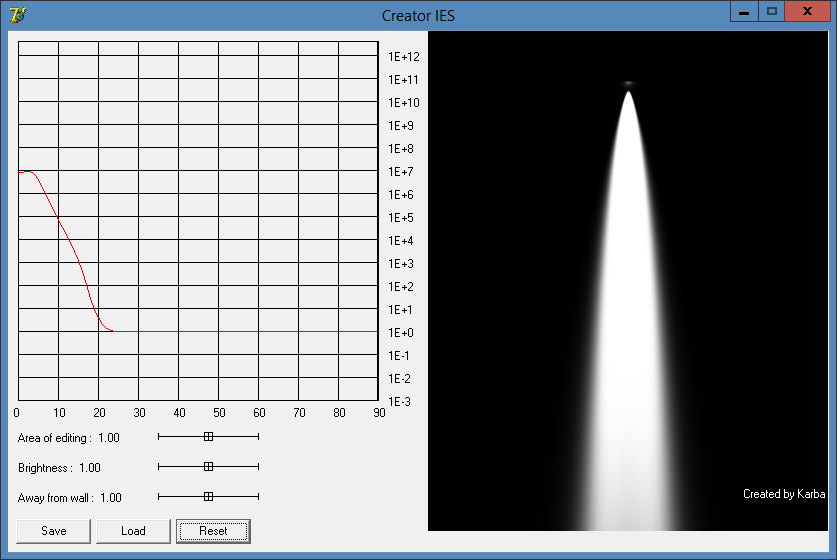

IES lights would be your easiest solution since you don't have to create any obstacles for the light rays to bounce off/through.
linvanchene goes in to detail in http://render.otoy.com/forum/viewtopic.php?f=44&t=44053.
http://www.cgarena.com/freestuff/tutori ... ndex2.html offers some more detail and a free IES editor.

It's looks complicated but if you play with the IES generator (link at the bottom), you'll see that it's not hard to get the results you want.

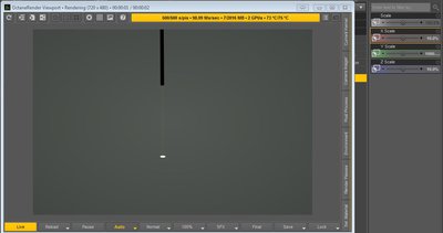

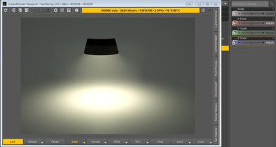

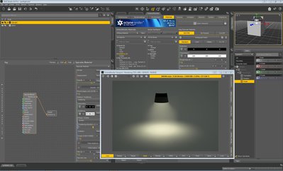

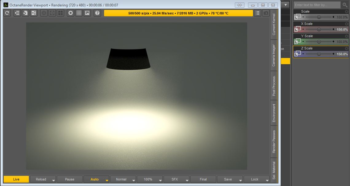

IES light are surely the best option, but here you can find a simple geometry spotlight setup:
It is basically an open truncated cone with the top face emitting inside:
Spotlight.7z
(27.46 KiB) Downloaded 200 times
You can change the Y scale for laser beam effect or change the X and Z simultaneously for different effects.
Note that there is a cube-fog nested inside, maybe you will need to adapt the scale independently from the spotlight. Be aware that the camera must be always outside the cube-fog, otherwise the fog stops to work.
It's my first DAZ scene that I share so be patient, I hope to have zipped all the necessary parts, let me know if it works, please ;)
Happy rendering,
ciao beppe
