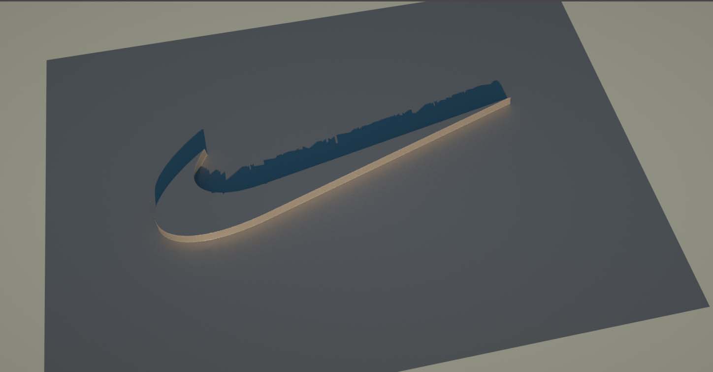

Can anyone tell me why I'm getting this aliasing problem around the edge of the tick?
The level of detail here is 8k, it's driving me crazy as I've got a mega tight deadline.

Any help smoothing the mesh would be greatly appreciated...

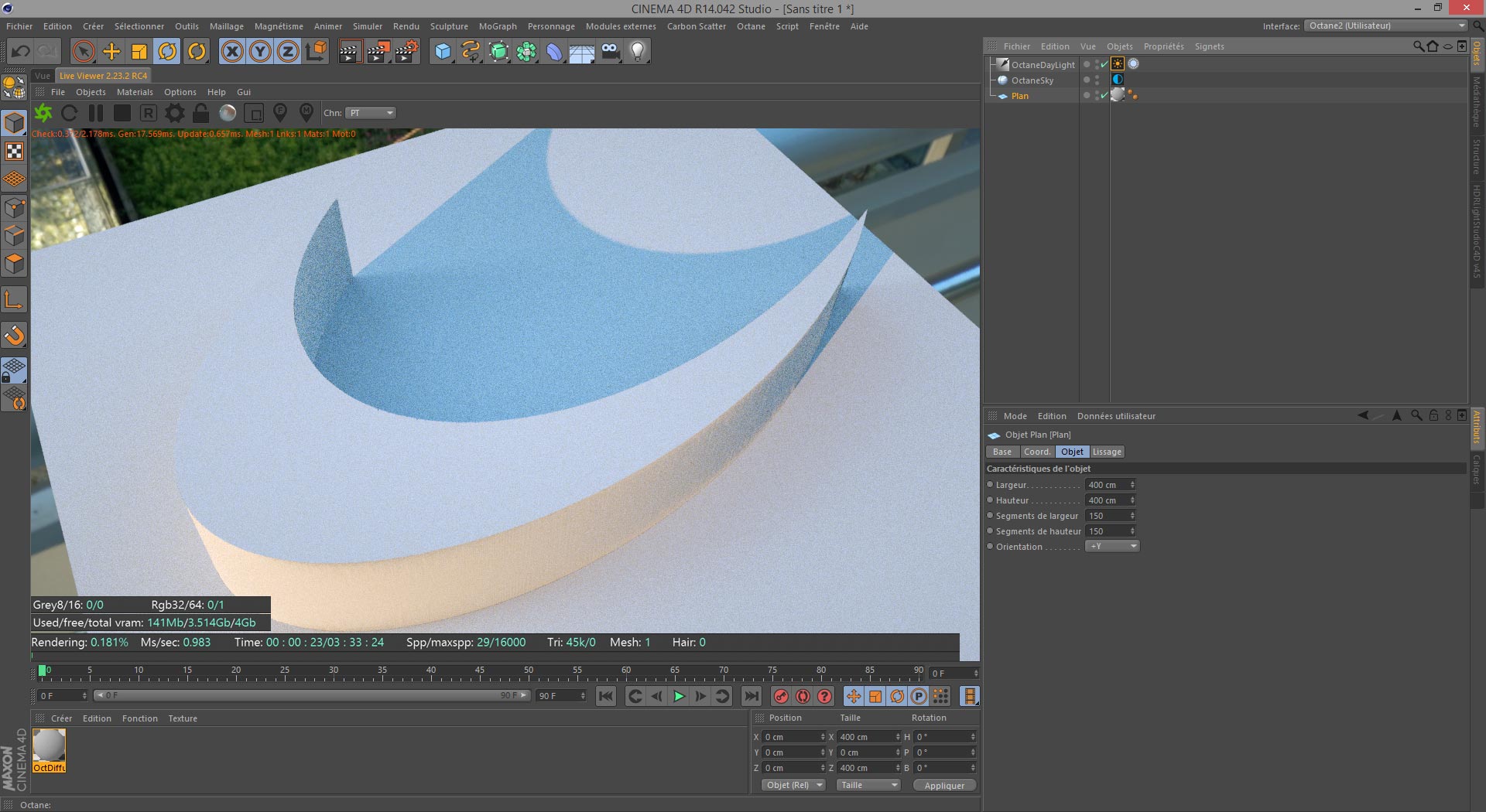

More than the blur, you need to feed the Octane displacement with a subdivided base mesh. By sample a plane with 150 x 150 polygons. Of course, it will take more memory... :roll:
Here a screen capture with a 4k 32 bits map without blur and a bezier curve.

Yep, that's it!!!!
Can't believe I didn't think of that as a solution.
I don't think that was covered in the tutorial but it feels like the most important part of the process to me.
Thanks a lot for your help atome451!!

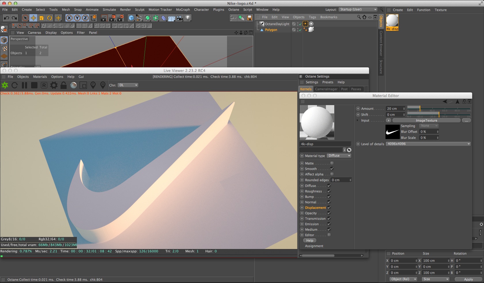

The quality of the map itself has the biggest impact, here is an example of one poly plane with a 4k 8bit map and 1 pixel gaussian blur:
In theory, the displacement should give high details to low poly meshes, the need to subdivide the mesh should not be necessary, in my opinion :roll:

bepeg4d wrote:In theory, the displacement should give high details to low poly meshes, the need to subdivide the mesh should not be necessary, in my opinion :roll:
You are right. That shouldn't be necessary... But if you turn your sun and reduce its size to see the curve of your displacement in a sharp drop shadow like in my sample, you'll see cracks in the curved shadow like the sample from GordonOfPallion. ;)
