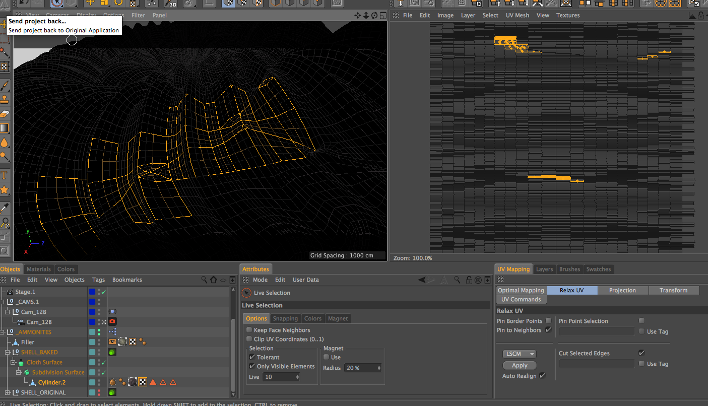

your UVs are all messed up

.... well this was a cylindrical projection and in any case how can that be the reason for a sudden shift in them?
I'm not sure I agree with what you say, these are the UVs of the object before being baked that I sent to the picture viewer and I don't see a problem....
Also, if the live viewer isn't showing me an issue - why should there be a problem in the picture viewer?
As I said, I get the same shift in texture before I bake the object and after it.

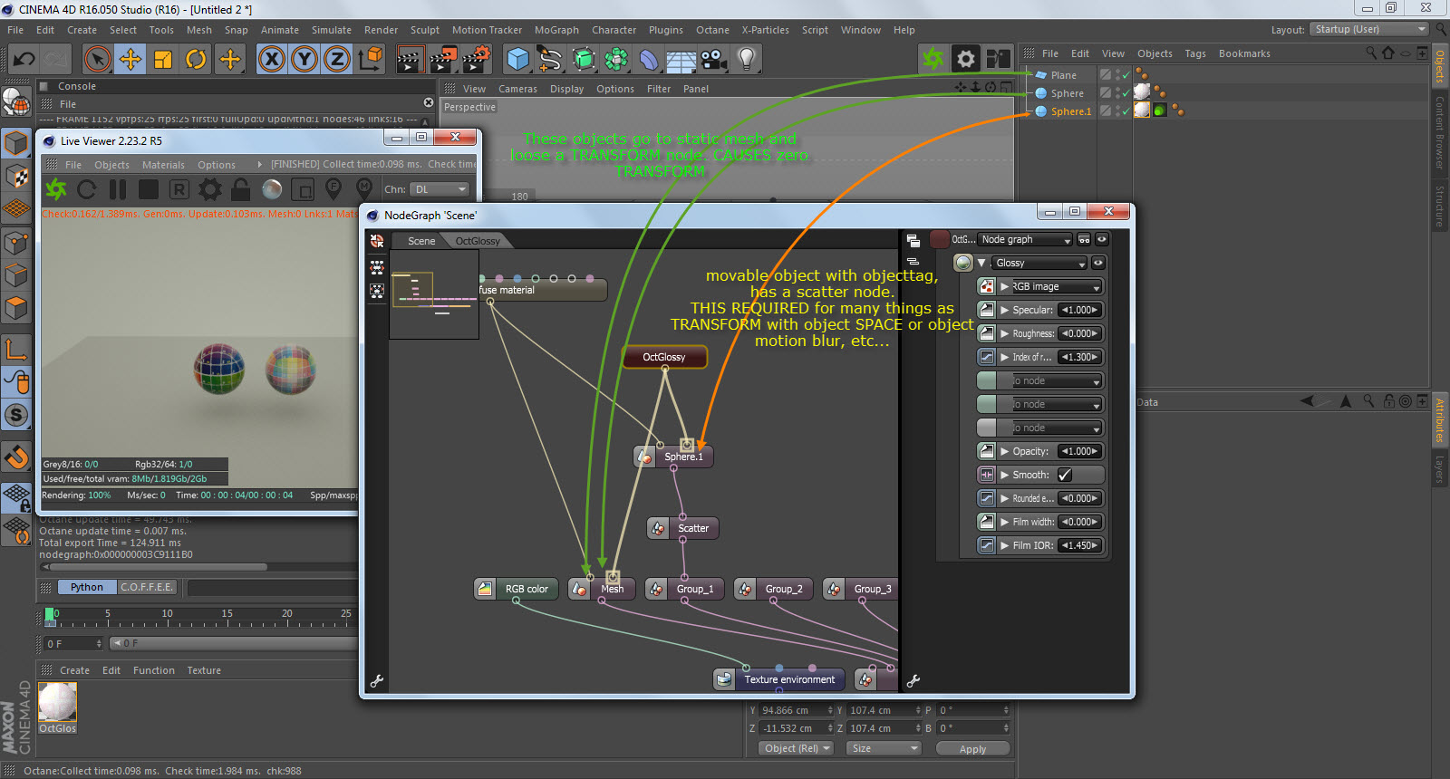

I'm out of office, so hard to test. But i see you that you have some TRANSFORM node with BOX type and OBJECT space. This requires that exported objects should have a Octane TRANSFORM node. Octane Object tag creates this node. I see you have it. Also you should render it on "Resend Only Updated objects" mode. I see that you are doing this. So i'll try to check more...
ADDED a image for you. I think you are on mistake which is similar. I'm not sure you got the logic of this.

I have never used the node graph for anything as I have never found it necessary.... can you access the node graph from Cinema? Sorry for my ignorance with this... I have never needed to use nodes for my scenes in the past. Can this not be fixed without entering the node setup?
Do I need to add the scatter node to something?? This all seems really complicated when I don't see that it should be when I have never had an issue like this in the past... what did I set up wrong?
A scene file would be helpful so I can see the difference in practice.

bleepurchin wrote:Hi Aoktar,
I'm not really following your diagram.
Many thanks,
Luke.
That's for just a deep info about background of structures. Exactly you DON'T NEED to OPEN or USE. Also after looking your scene, i think you don't need to use this for this situation. But try to understand why we need. I'll try to do these operations automatically on NEXT VERSIONS. Nevermind atm.
But i think your problem is TO USE a BOX projection. And animate the vertexes. This projection works as 6-sided projector and THAT'S NORMAL to produce a shift in this scenario. So you should USE UVW mapping in Octane node and Select any kind of mapping type in TEXTURETAG.
