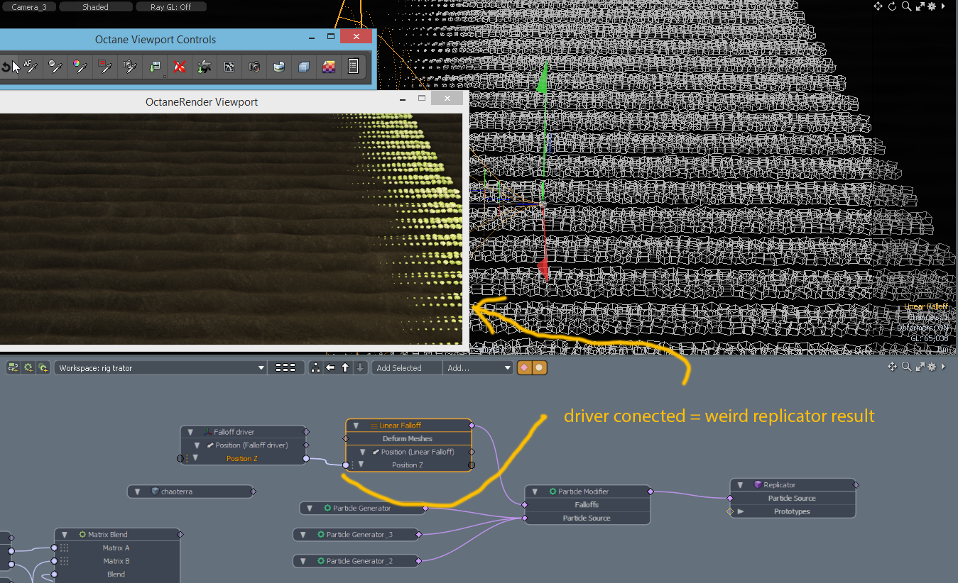

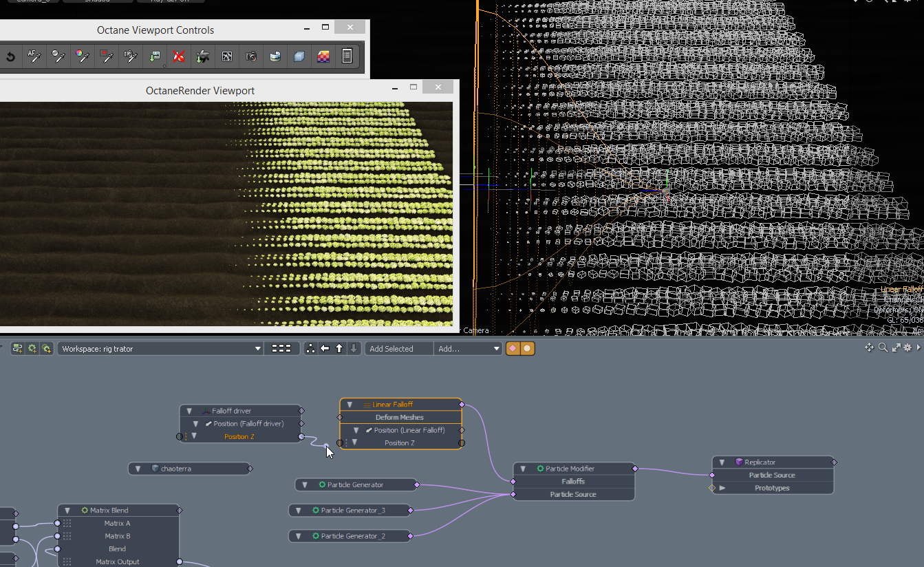

Hi, i'm getting some issues using replicator and a particle modifier to change it. Every time that there are something driving the falloff, it get a strange behaviour. like an animation or other driver in the position channel. you could see it in the screenshots. in Modo render its all fine, its a octane issue.

Hi - can you send me the scene causing problems pls?

Hi Paul, i recreated the problem in a new scene, and when the falloff is just driven, it works well. But if its animated or the driver is animated... the result comes weird. here is the link to the scene:
https://dl.dropboxusercontent.com/u/443 ... rouble.lxo

Thanks for supplying this file Marcus. This problem is fixed in the next release. If you have an urgent need for the fix, pls email or PM me and I will send you a pre-release.
