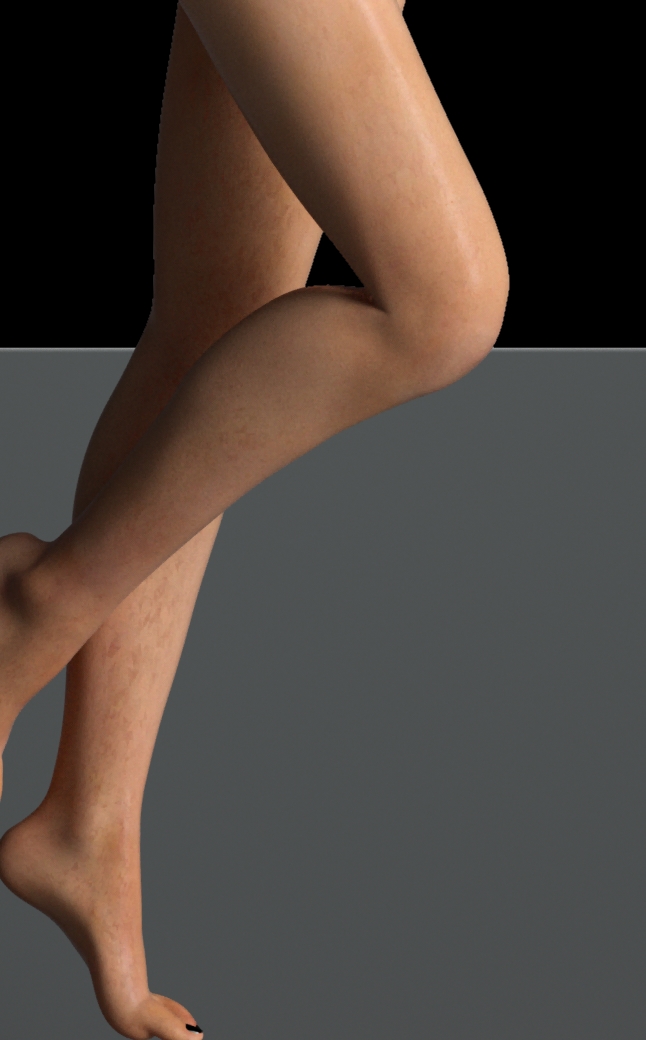

OK this is weird. I searched around and didn't see this come up before, but maybe I have missed it.
V4, any texture, even the mapless one and I get diamond shapes and other patterns. It happens with the default conversion
of materials to Octane, and it happens if I apply REDSPEC.
This happens on 660TI and 980TI makes no difference.
I am running latest standalone and Poser plugin releases and latest NVIDIA drivers.
See attachment.

Could be an issue with aliasing...
Is Smoothing enabled on that character?

Do you mean on the individual material settings or somewhere else ?

Try reducing the Kernel->Ray Epsilon. http://render.otoy.com/universe.php#44R ... %20Quality

Thanks Paul. I had it all the way down to 0. Setting it to .00001 fixed the issue.
Not sure why I had it there, thanks again.
