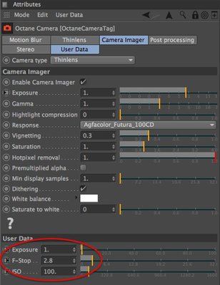

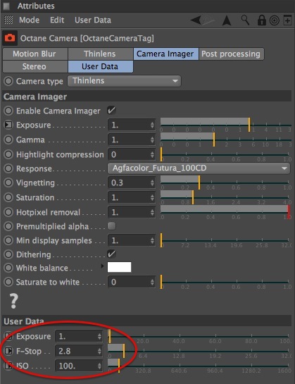

now you have to consider only the exposure value, the idea is to use the slider in realtime for fine tuning the general exposure ;)
I have tried to convert the old-school-exposure lua script, provided by the team here on the forum for the Standalone, in an expresso tag:
OldSchoolExposure-expresso-01.c4d.zip
(42.29 KiB) Downloaded 159 times
You have to use the parameters in the User Data slot. It seems to work quite well, but I'm not a programmer so I have no responsibility for any damage in your scenes :D
ciao beppe

Anyway, as you can see, the three sliders do the same thing, only with different scales ;)
