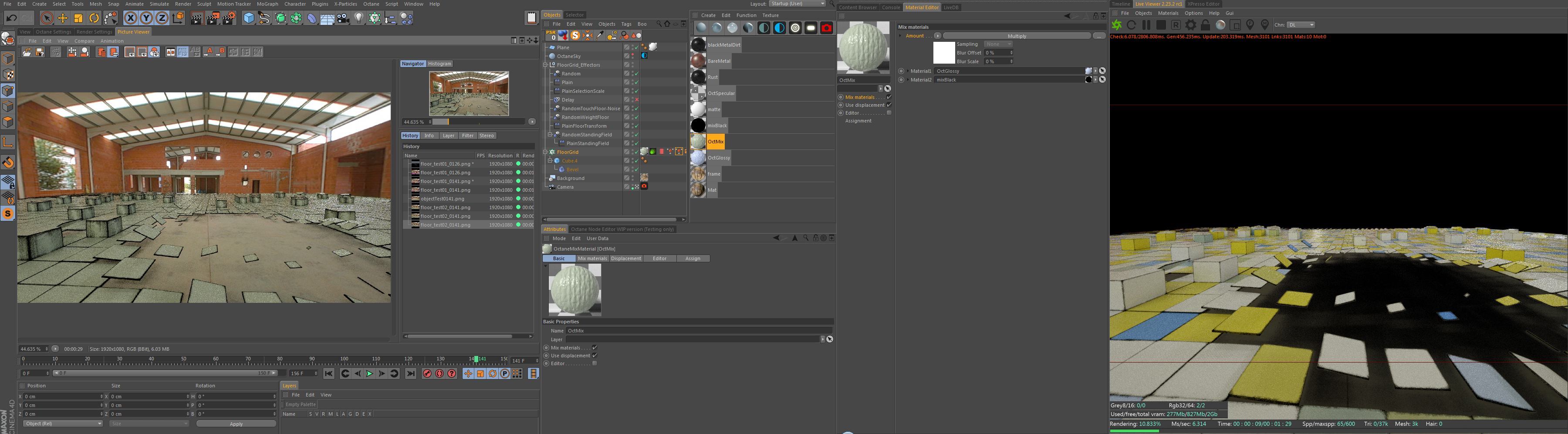

Hi there,
I got a mograph color shader insider a c4d colorizer (i'm limiting the random colors to a defined gradient) - That seems to work properly,
I'm putting this material inside a mix material - Then the mix material is applied to a cloner to get a "mixed-material-random-colored-clones".
Now - When i'm rendering to the live viewer sometimes the shader works and sometimes it doesn't (refreshes dependent)
& When i'm rendering to the picture viewer i can never get the shader to work. What am i missing here?
scene & screenshot attached.

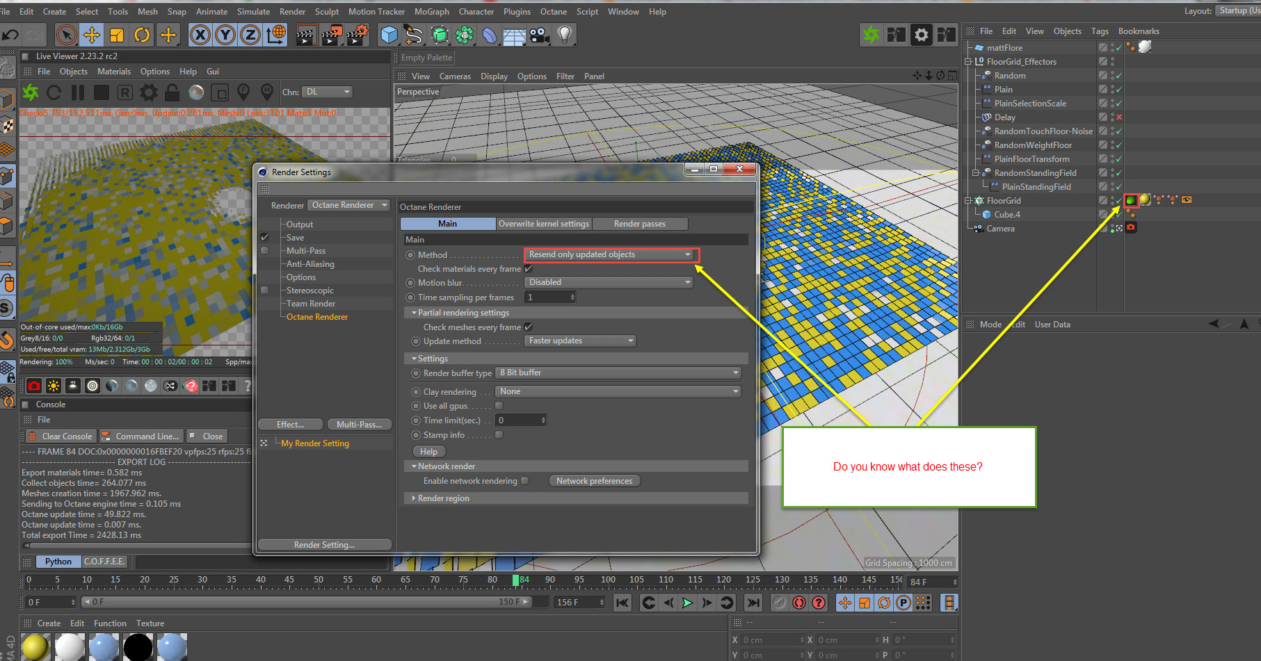

first i have to ask a question as you can see in image.

Of course, I've double checked it before i posted this.
Resend only updated objects / all scene data doesn't effect it. The color shader inside the mix material still not rendering to picture viewer.

Yambo wrote:Of course, I've double checked it before i posted this.
Ok sorry. I may check wrong. Looking again.
