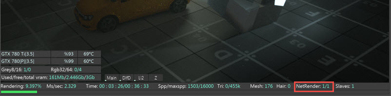

Can you do some tests? Use light-weight objects to test render contribution of client. You can check when a client start to contribute rendering. See "Netrender:1/1" in picture. First number shows the numbers of clients which start to render.
