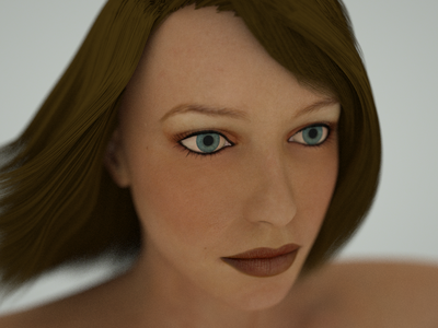

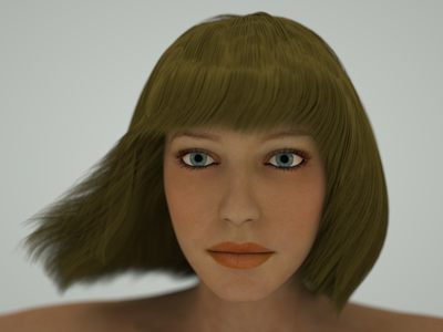

A couple of (badly) rendered hair models...
Skye Hair
Skye Hair
Paige Hair
Paige Hair

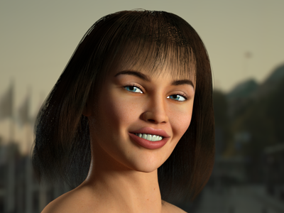

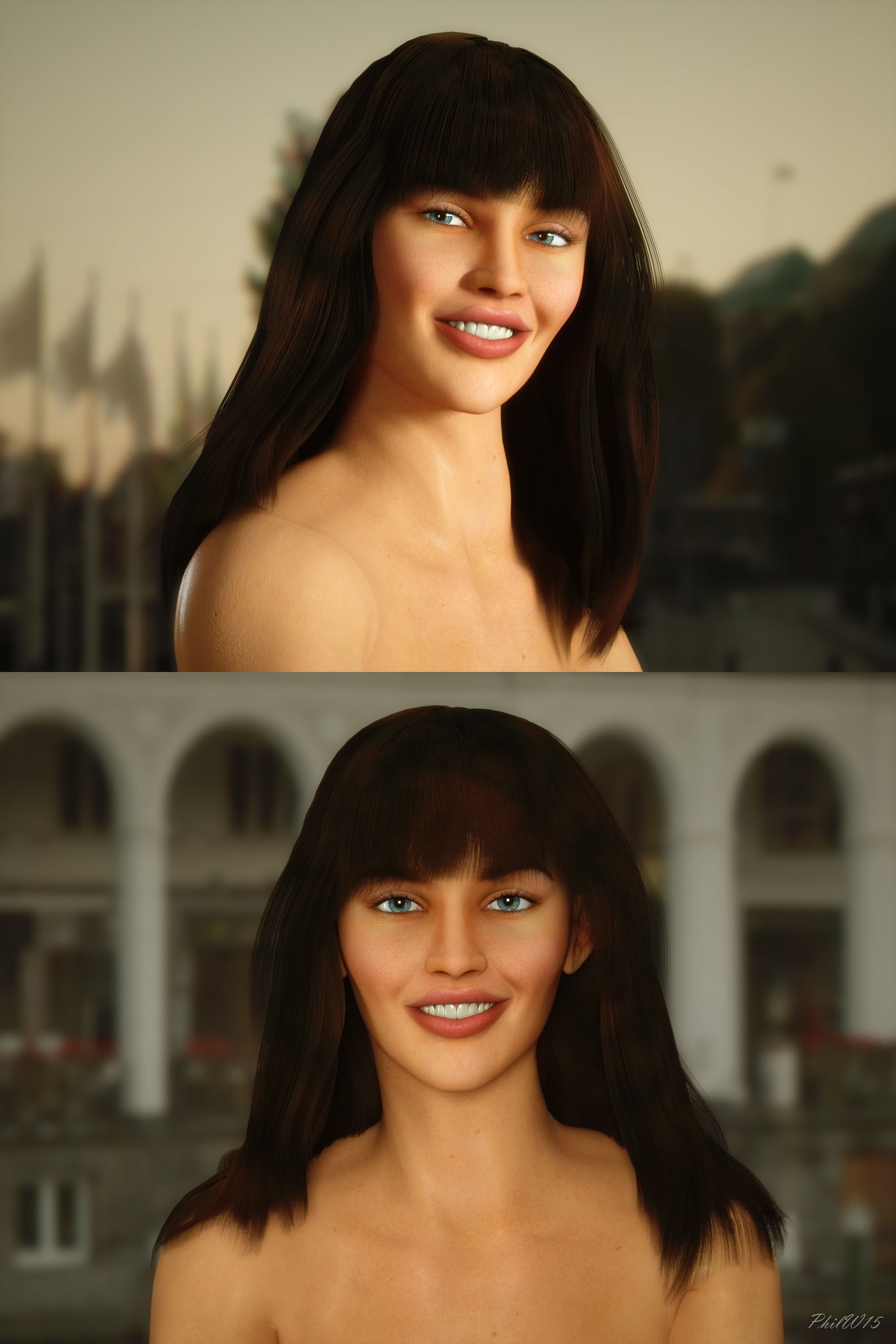

A couple of better images with Carrara hair rendered in Octane. These use an edited version of Paige Hair.
