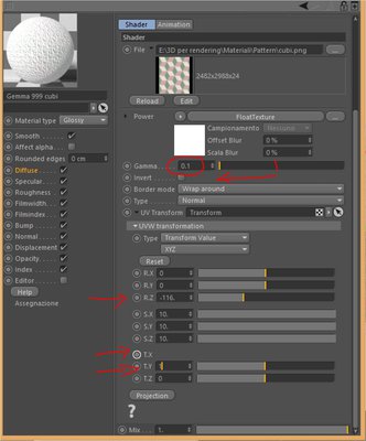

Hi Aoktar,
I have encountered a bug when I have tried to rotate a texture, on diffuse field.
I had selected UV Transform and then as I have rotated the R.Z axis the T.X and T.Y fields automatically was changed from default 1 to 0. Also Gamma was changed form default 2,2 to 0,1!
Then I have tried to change the T.X and T.Y fields, and C4D freezed immediately!
CTRL ALT CANC to stop.
Plugin and Standalone v. 2.23.2 - C4D v.16 - win 8.1 64 bit
bug on texture UV Transform

it's a bug on octane floatsliders. If you open sub sliders this can occurs. Not a bug else other.
yes, possible. Don't make unfolded the sub controls.augdalmo wrote:but it caused a crash of C4D
i think that you got it wrong? Solution is to not open the sub controls by this way. Custom sliders can't work like this. Or use c4d's default slidersaugdalmo wrote:Hi Aoktar,
I have installed now the rc 2 of 2.23.2 plugin, this bug occour also on this release, do not believe it is appropriate to temporarily remove this function until you find a solution?![]()
