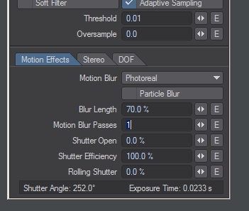

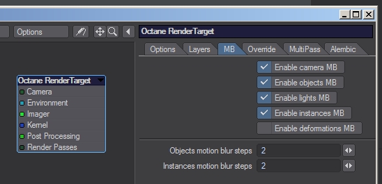

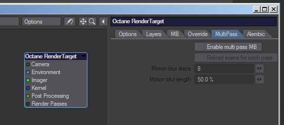

Nope, I think that you are enabling the old "multipass MB". Don't do it !!! ... multipass MB should only be enabled for special cases (MB in some simulations or hair). It is really slow, and not useful at all to render MB in the 99% of the scenes.
You need to enable the MB in the camera and set the MB parameters in the render target like you can see in the attached images. The MB length is controlled also with the LW camera length parameter.
