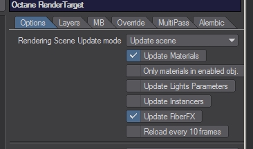

Can you please make other test? ... render the scene in update mode, but be sure to enable the "update materials" and "update FiberFX" options. Perhaps this could work without reload the scene.

No, that is no option. With update materials and Update FiberFX the Octane Preview Window get's stuck.
For more than 5 minutes it is "updating scene ..." and "Abort" does not work. I have to kill Lightwave and Octane by using the taskmanager.
It's better to fully reload the whole scene.
But it's funny: Layout CPU 0% and I can't find any octane process (I don't know the name of the octane process).

Yes, I think that the only way to render this kind of scenes with animated parameters in the FiberFX is to full reload the scene for each frame. There number of fibers in each frame is not the same, and the update process fail.
