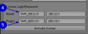

OK. I download 3ds max 2016 just to get information that its not supported yet, so i decided to check out blender with octane but again instead of username and password i have 4 empty fields to fill in. Any idea what to do with this stuff?
places to fill in
Stand: two empty fields
plugin: two empty fiields
and below is the button activate

This is stated in the header of these fields group what are these fields for: "License Login/Password".
So, you need to fill in the license activation Login/Password pairs into these: the Octane standalone Login/Password into first row, and the Blender plugin Login/Password pair into the second row.

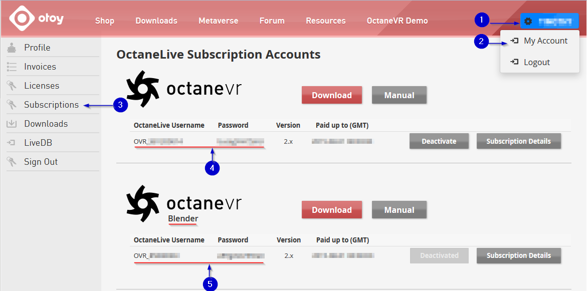

You can find your licenses login/password pairs in your user-area, in "Subscriptions" section.

in my subsciptions panel i have user and password .. but in my licences there is nothing. It looks like i have to buy octane licence to check it out with blender

To apply for a 3-Month trial of OctaneVR for Blender, click here:
https://render.otoy.com/shop/process_fr ... ?product=1
To view your trial subscriptions, go to the Subscriptions page in the Customer Area here:
https://render.otoy.com/account/octanel ... censes.php

You will need to enter your OctaneVR subscription credentials into the top two boxes,
and your OctaneVR Blender subscription credentials in the lower two boxes.
